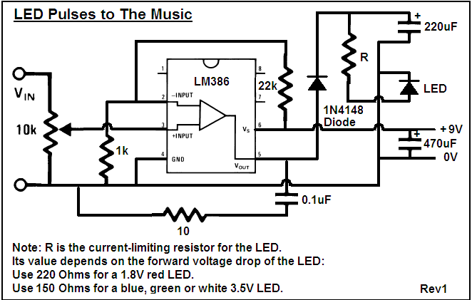

how do u build a led that pulse to music of a personal cd
nooby
my full question(how do u build a led that pulse to music of a personal cd player or a tape player???? is it posible????? and can it run on a 9v battery?
and if it can, can u tell me the parts i need and can u give me a diagram of what it should look like when it is done? :)
just starting in to the world of electronic's and i under stand the basic's and sum of the hard stuff so can someone anser me??????? :?: :? :)

Making a circuit to flash an LED in time with the music isn't easy for a nooby. It needs a low frequency audio filter, a rectifying circuit and an LED driver. Maybe you could plan it so the LED driver also rectifies the low frequency audio from the filter stage. Then you need to design a printed circuit board or Veroboard layout for it.

How is your circuit going to pick-up the signal? If it is a microphone, then it needs a preamp in addition to he other stuff. If it is from the wires that connect to a speaker, then it is much easier.

If it's connected to the speaker output of a stereo, just the LED, a rectifier diode and current-limiting resistor is probably all that is required. Simple.
Instead of the rectifier, two LEDs could be connected back-to-back in reverse parallel. :lol:

A stereo VU meter is 50% of the solution. Hook it up to an amplifier output, then hook the amplifier input to your CD player earphone jack. Once everything is correct, you will see an LED go with the music.
Hi Nooby,
This circuit might work.
EDIT: Current-limiting resistor values increased to reduce max LED current. Value of rectifier filter cap increased so that LED indicates for about 50ms.

For Nooby and others who want to fool around with an LED (or few LEDs) to pulse to the music, I sketched a Veroboard (stripboard) layout of my circuit previously posted. Also it is easy to increase the gain of the LM386 amp and add a biased electret microphone to its input.

My circuit plugs into the earphones jack like you wanted. The output level from an earphones jack is too small to drive an LED directly, therefore my circuit uses an amplifier and its own battery. You can connect my circuit to both stereo channels with a 1k resistor from each channel at the earphones plug to its input pot. :lol:
