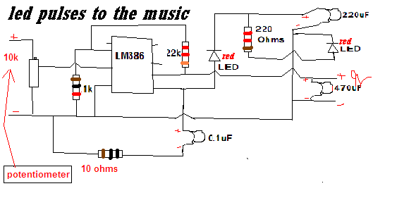

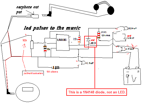

N nooby New Member Jul 25, 2005 #21 is this what it should look like (right)? Attachments led_music_pulses__kev_version_.png 23.5 KB · Views: 689

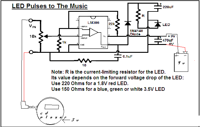

audioguru Well-Known Member Most Helpful Member Jul 25, 2005 #22 Hi Nooby, Perfect! :lol: Hookup the wires from the input cable like this: Attachments led_pulses_plug_wiring.png 24.4 KB · Views: 671

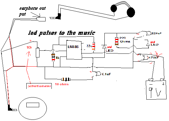

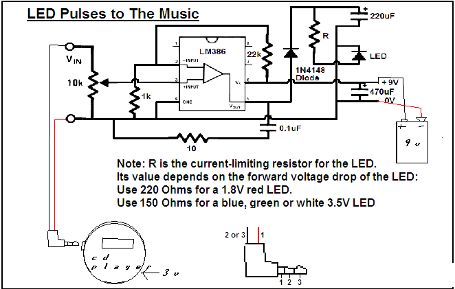

N nooby New Member Jul 29, 2005 #23 please anser the question?!bellow Attachments led_music_pulses_2_cd_music.png 26.9 KB · Views: 627
audioguru Well-Known Member Most Helpful Member Jul 29, 2005 #24 See remarks. Attachments led_music_pulses_2_cd_music_192.png 33.3 KB · Views: 629

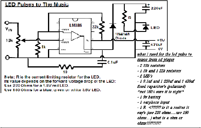

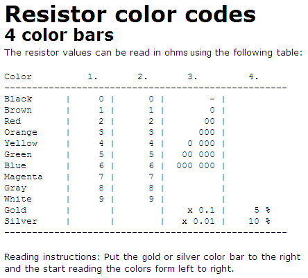

N nooby New Member Jul 31, 2005 #25 please fill in the lines and colour's 4 the resistors Attachments pulse_to_the_music_curiit_board.png 11 KB · Views: 587

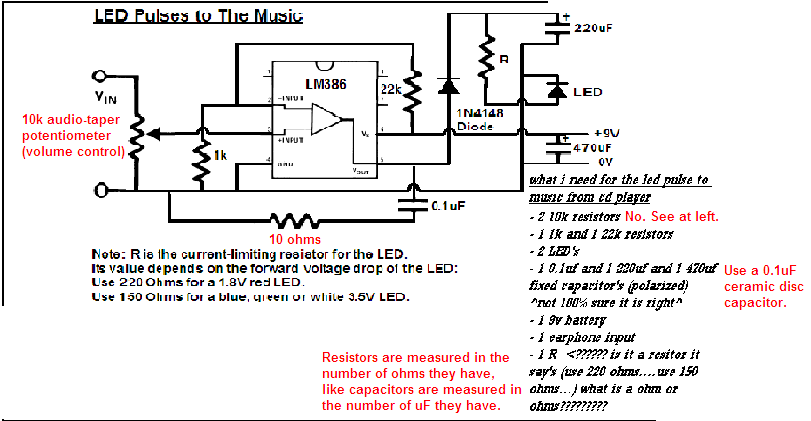

audioguru Well-Known Member Most Helpful Member Jul 31, 2005 #26 Hi Nooby, A little bit of homework for you: EDIT: I fixed its spelling and grammar errors. Attachments resistor_colors.png 14 KB · Views: 597

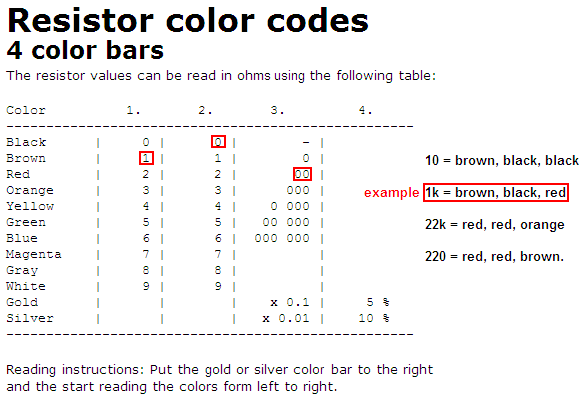

N nooby New Member Jul 31, 2005 #27 1, 10, 100, 1000, 10,000, 100,000, 1,000,000, 10,000,000, 100,000,000, 0(none)
N nooby New Member Jul 31, 2005 #30 so 4 10 ohms has 1 black line and 1 brown line????!!!!! :?: :!: :?
audioguru Well-Known Member Most Helpful Member Jul 31, 2005 #31 10 ohms is brown, black, black. The 3rd color of black shows that you don't add zeros after the 10. :lol: EDIT: Corrected.
N nooby New Member Aug 1, 2005 #32 i would need : 10 ohms=black/brown/black 1k=1,000 ohms=brown/black/black/black 22k=22,000 ohms=????? 220 ohms=red/red/brown/brown/black????
Dr.EM New Member Aug 1, 2005 #33 Tolerance (gold) stripe on right: 1K - brown, black, red 22K - red, red, orange 220ohm - red, red, brown
audioguru Well-Known Member Most Helpful Member Aug 1, 2005 #34 Sorry that I got 10 ohms wrong before, I've corrected it. Attachments resistor_colors_190.png 17.7 KB · Views: 904
N nooby New Member Aug 1, 2005 #36 thank's now i can build it , and ill tell u if it work's ok :wink:

audioguru Well-Known Member Most Helpful Member Aug 1, 2005 #39 Almost correct. One LED is supposed to be a diode. Your 220uF and 470uF caps look like little 220pF and 470pF ones. Attachments finished_pulse_led_4__cd_player_106.png 15.9 KB · Views: 754
