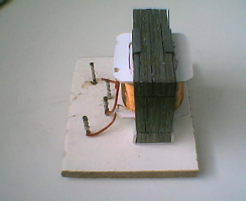

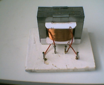

here is one of my home made transformers, i took the core from an old knakked one. It has a turn ratio of some thing like 200:1, i used it to step 12V up to about 2,400V. the plastic you can see started life as square PVC drainpipe, i shaped it with the heat from a soldering iron. the wire guage on the outside is #18SWG and internal is #32SWG. i wound it with a drill, another method is to wind the primary on the bottom half of the core and the secondary on the top. this transformer does not work as i killed it with overvoltage, was pretty funny though.:)
