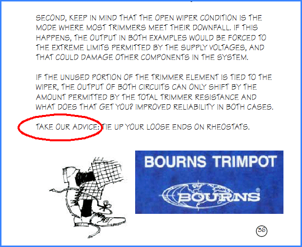

Tie up the third pin is actually recommended by the trimmer manufacturer.
Apart from the reasons that Audioguru and others had said, connecting the third pin would effectively put the wiper contact resistance in parallel with the unused portion of the trimmer thus helps to lower the contact resistance and improves circuit reliability even when your trimmer is new.

I'm not surprised. Even the trimmer manufacturer remarked that 50% of users do not aware of the reasons of connecting up the third pin, that's why they specially mentioned it in their literature.

It is interesting that Bourns actually admits that their products are failing.
Something like the disclaimer from semiconductor manufacturers on their datasheets: "Not for use in applications involving life-support. When our product fails and kills someone or causes an expensive disaster, you can't sue us!" :lol:

I hate wiper contact resistance gets in the way of my gain network and using the third pin at least helps in reducing the effect. That's my reason and you are free to form your judgement about it.
