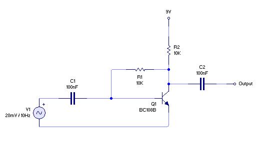

How do you determine capacitors in this circuit?
gjpollitt
Can anyone please explain the effect of using different sized capacitors C1 and C2 in this basic circuit?
Would you need to take into account capacitve reactance and if so how would that affect the circuit with regards frequency input/output?
Am I correct that this circuit has a gain of 10? R1 should be 1k !!
Many thanks
Graham
