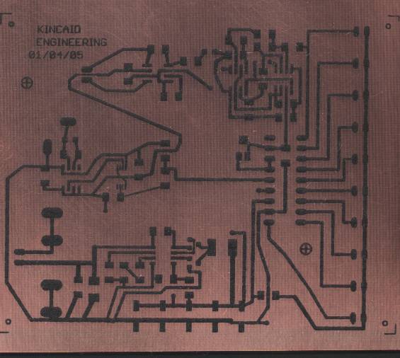

This is my latest layout:

I have never had any problems even with surface-mount parts. if you get your toner density right, and your ironing technique down, you don't get much spreading of the toner during transfer so you can get away with very fine traces (yes, even 10 mil spacing)
note that one main difference between my method and "the usual" method is that I set my iron to only 2/3 heat, rather than all the way. For those of you who routinely do toner transfer, I suggest you give that a try at least once... since I've started doing it that way i've had 4 boards in a row come out perfect (one rather large one, see the pics on my tutorial page), with minimal trace spreading or blobbing, and few to no broken traces, etc.
Also, I use a totally different etching method than most. I prefer sodium persulphate over ferric chloride because it's almost as fast, but it's crystal clear so you can really see the progress. I do my etching in a ziplock baggie, which allows me to use a very minimal amount of etching solution (1/4 cup of water, a couple tablespoons of powder usually) and also allows me to agitate the solution by hand, and focus on areas that are etching slowly. and when I'm done with the solution, i can just dump that tiny bit down the toilet and throw away the bag.

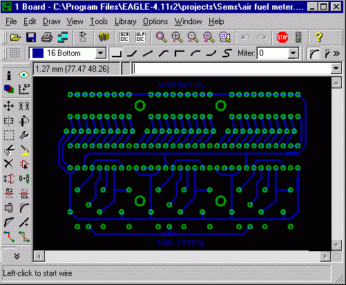

Hanyman, what version of Eagle do you have? I have 4.13r1 and it does not have holes in pads, which makes drilling difficult. Also, the print function does not work. I thought it was something left out in the free version, but maybe I just don't know how to do it?
I have 4.13r1 also. Do you mean the pads on the screen do not appear to have holes? Mine are on screen and present when printed out, even if the track I lay seems to cover the hole on the layout.
The print function works for me, although I found that it seems quirky, and to get mine to print at all, I always have to click on 'printer' within the print dialogue box and then pretend to change the printer settings, etc., before clicking on 'OK' and 'Print' which then takes me back to the original box. When confirming the job in that box, it starts printing properly. Otherwise it will claim to be doing the print job but nothing will happen at the printer end.
Thanks for the reply, yes, no holes any time. The printer problem is the same with me, I had not figured out how to make it work. I have been in contact with Eagle email help, I will ask about the pad holes.
Russ

There is a forum on Eagles web site that may help you.
I have used the Free eagle versions 4.11 and 4.13, but never had problems printing the holes.
