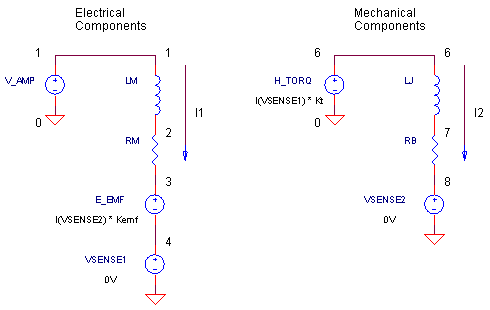

how do i model a 12V 1.2A motor in LT spice? i am guessing i have to use an inductor as the motor is a inductive load, but how do i work out what size inductor and do i need to add anything other than a inductor (i know about adding flyback diode i am just asking about to model a motor)
I like this model very much:
http://www.ecircuitcenter.com/Circuits/dc_motor_model/DCmotor_model.htm
I hope the website explains the details. If not, ask.
It is difficult to say what is the inductance of you motor winding etc. You need to measure the component, if you do not have a datasheet. You need total of 6 parameters to properly simulate an electric motor. The website has an example table of these parameters.

Yes. Disconnect the motor and make sure that the motor can't spin. Then try measuring from different positions (turn the shaft to different angle).. take an average of the measurements or something like that.. or the "best" measurement. It may give wrong measurement at some angles. Not sure.
