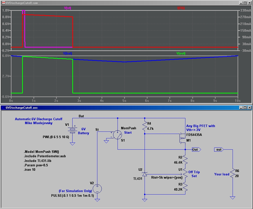

Look at this from a previous post:

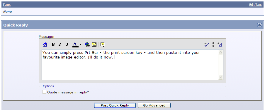

You can simply press Prt Scr - the print screen key - and then paste it into your favourite image editor. I'll do it now. This enables you to attach any image that you can display.

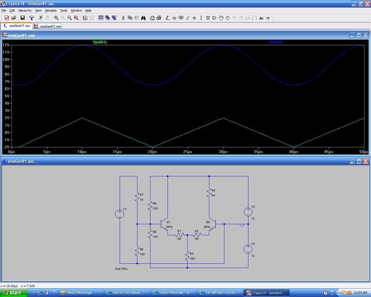

I'll give that a try. My JPEG was a little fuzzy, but my wavefrom was almost too dim to see.

Oh I know, this is the "before" image :)
