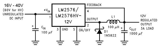

100 uH Coil
how do i make 100 uH coil for this circuit ? actually i want to run a lcd screen (2 amp) with this power supply instead of direct 70 amp battery in order to protect lcd from any mishap or power fluctuations.
please guide me as i am newbie in this...
further more how can i measure inductance so i can calculate at my own if i need some other numbers, as normal multimeter can't help.
You should have probably made a new topic.
You have 16v to apply to the input? If so, find a coil online that can handle the peak current and buy it...that's the best way.
I could post formulas but you want wont to use them.
Sorry, i thought its related with coils so i ...

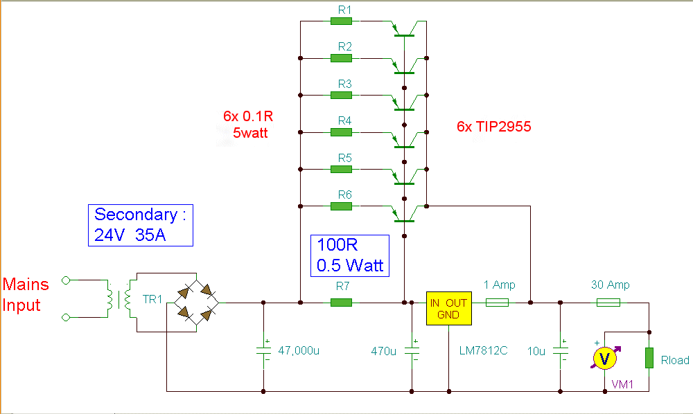

Thanks MrAl, I spent two hours in electronics market searching for the components required to build that power supply but only this coil does not seems to be available. I am not sure whether I Build this circuit without coil or use any close value (again guess) from an old computer power supply.
Any way i got another circuit on internet but i used only two transistors as i need under 10A current last night I checked its working ok but could not check current as input power i used was of 1 amp and circuit output was around 1.4 amp. (i think it is working ...)
now i will check it on car battery 65A : )
