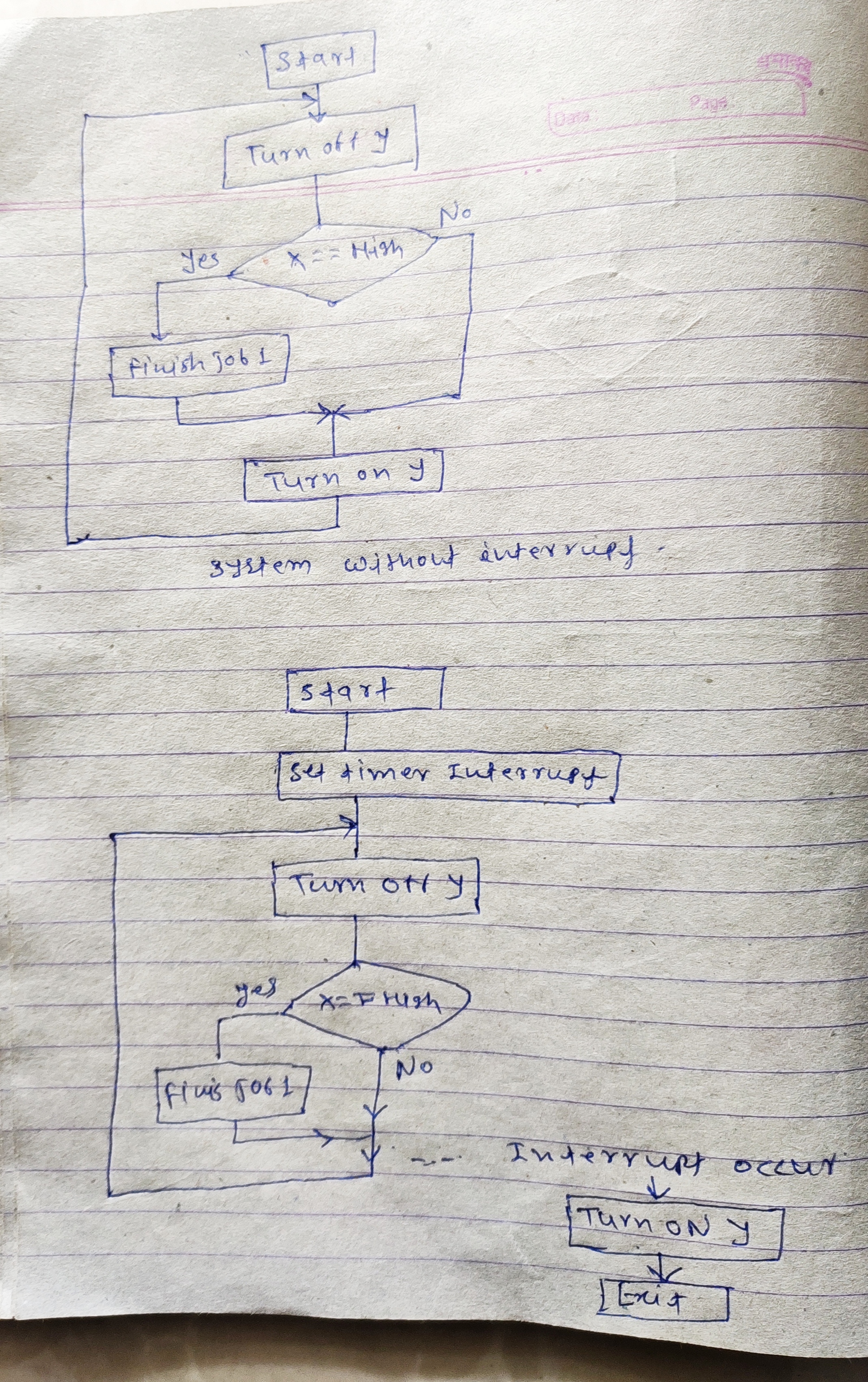

I have general questions, assuming we have PIC12F1840, Sensor X to detect object and Output device Y.
Task 1 ,When sensor detects object, micro read the output of sensor and finish first job
Task 2, Turn on device Y
Response time of X is 60 ms
Response time of Y is 30 ms
How much approximate time PIC micro take to complete two tasks?
Any reason it wouldn't be 90mS?
Thanks Mike, so system take 90 ms to complete two tasks
But can both these tasks be completed in less then 90 ms time?
I think this can be done using timer interrupt. If yes then how long will have to set the timer interrupt?

it is a theoretical question . I am not doing any practical. I just want to understand how can we save CPU time at the time in program design
As given in my example, pic micro take 60 milliseconds to read sensor state but pic is faster than sensor so it takes few nano seconds to read sensor so pic is just waiting so much time to read.
Input response is so late that's why I want to do second task between this time
So I think timer interrupt may play important role in the system

Not at all, it seems an unlikely use for a timer interrupt, mostly simple loops are all that's required.
Bear in mind, the 12F1840 you mention runs at up to 32MHz (on it's internal oscillator), this means it can execute 8000 instructions per millisecond. PIC's generally spend almost all their time just waiting for an external event.
If you just ask meaningless made up 'general questions', you'll never get a sensible reply, because there can't be one - every solution is different, although anything similar is likely to be done in a very similar way.
Personally, I'd use an input capture so the PIC can be doing other things until the sensor returns a signal, if high precision is needed, or just check the input in a fast timer interrupt for lower precision. With 10KHz interrupts you would get roughly +/- 0.7" or 17mm steps.
Ultrasonic measurement is a very slow system in computer terms; the round-trip delay is almost two milliseconds per foot distance.
One of the most basic principles of real-time programming is never use delay loops - use interrupts or proceed with the main program and check again next time around the loop.
The actual calculation time to convert each reading to distance units would be a few microseconds at most.

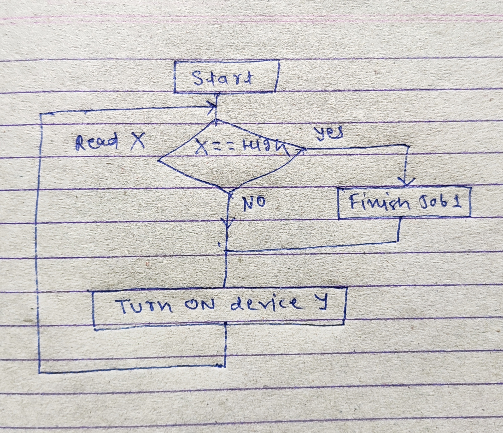

When I am designing the program, I have two methods. In which I have to choose best one .
I think the interrupt method is the best because it take less time so systems will work at high speed. Obviously this method will benefit in complicated system
If you use a reflective opto sensor to detect the item then reading it will be almost instantaneous. BTW, you won't learn very much with theoretical questions.
Can you please clarify why I should not use timer interrupt in my system. If I use the interrupt, I do not see any disadvantages in my system, My system takes less time because of interrupt. Where is the reason to avoid timer interrupt?
He's not said anything like that - he merely said, as many of us have, you're asking theoretical questions that won't help you in any way, as any answers are just as theoretical.
As you've never given us the slightest hint what you're wanting to do, (and most of your questions make no sense) we can't suggest if timer interrupts are a good idea or not.

There's no need for a timer interrupt. An edge triggered i/o inerrupt would make more sense. Why do you think interrupts make things quicker?
An interrupt won't necessarily make things faster, it will just make the timing deterministic if you use the interrupt as a "throttle".

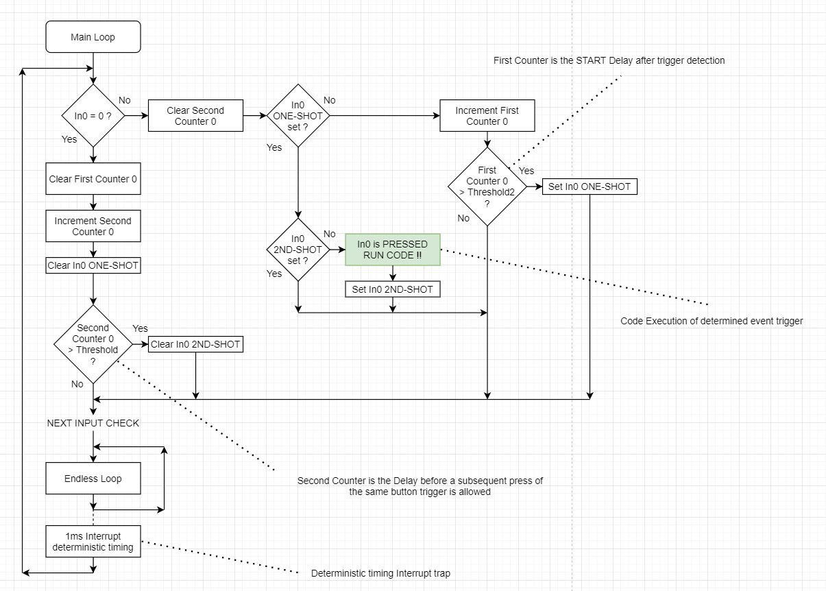

By making things deterministic, (i.e. setting your interrupt to have a 1ms "heartbeat") you can create your delay loops so they always have a predictable interval. That way if you add more switches or sensors in code, the delay does not become code dependent on other delays previously instantiated.
We have a similar situation at work where we are checking an IR reflective sensor... on occasion the bottle on the conveyor belt creates a false reflection reading. So on our debounce circuit there are two delays ... one that prevents false triggering and waits after the first trigger of the event, (when the pin goes HIGH), and another that triggers after the pin has gone LOW ... the flow is designed as a "fall-through" so that any one delay does not hold up valuable CPU time so that another delay can be handled in an atomic way.
The Flow chart below only depicts ONE input. The reference to 2ND-SHOT is simply a second ONE-SHOT flag.

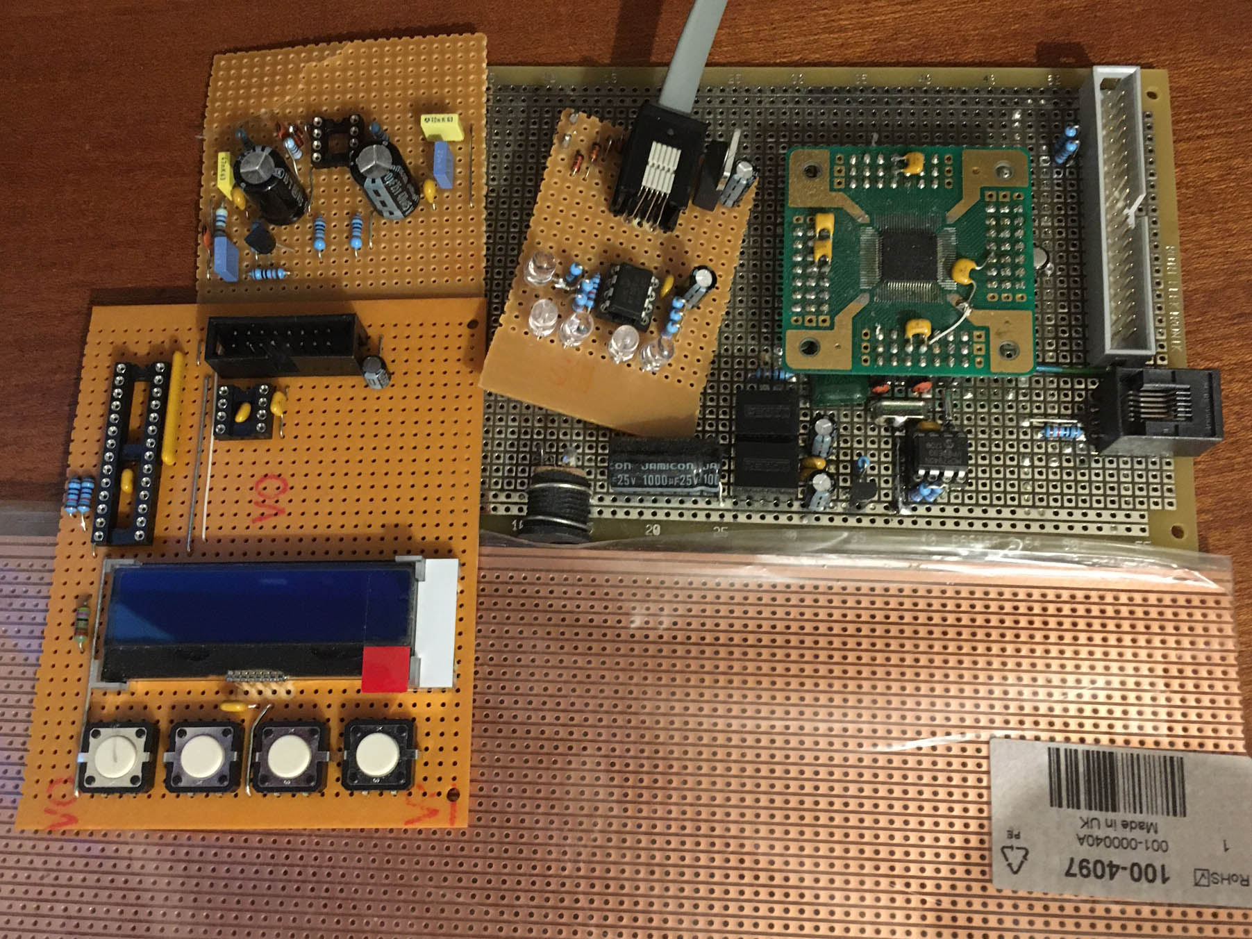

What actual chips and sensors do you have available to you?
I do not have a development board at home. Schools are closed due to covid 19. As soon as possible I will have new development board. I know I can not test program without board, that's the reason ask some theorytical question
You do not need any specific "development board" - just get some stripboard, IC sockets and appropriate components for whatever project you want to try.
It's then permanent, rather than something that has to be scrapped to do something different on the development board.
You do need a programmer to work with PICs, but you can get an PICKIT one quite cheaply from ebay.
These are a few bits of mine, within reach of my desk at the moment:
