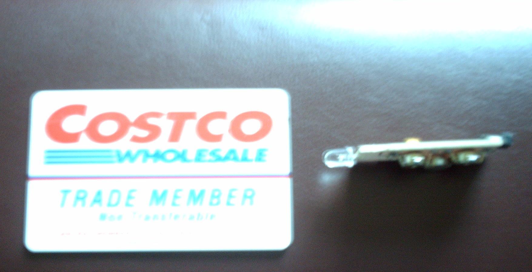

Well it all started a month or so ago. I had a call from one of my Distributors saying he had a little project for me.
Design spec was to make an LED flash. Not a problem I thought and went over for a meeting.

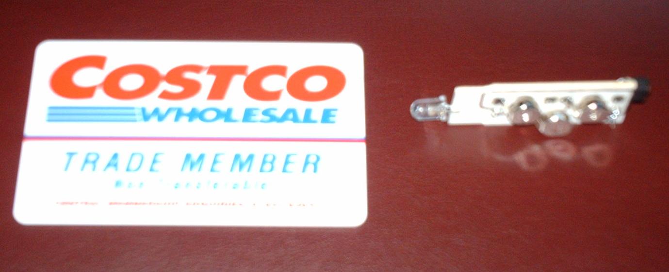

LED was initially a 1W Luxeon - still not a problem. Housing for project was smaller than Luxeon - ok - problems start ;)
Maximum size of PCB which had to include the batteries (3 button cells), a switch, the flashing circuitry and the LED was now restricted to 40mm by 19mm - by the time I mounted 3 x SR41 cells on with the holders there wasn't much room left.
Found a 5mm LED which gave the correct viewing angle for the project and knocked up a flip flop out of transistors. Prototype looked feasible so we went out and bought some dedicated MT flasher ICs in a TO92 package. With a on/off ratio of 7:1 the batteries should last around 6-8 hours.
Knocked up some "semi-final" prototypes and my Distributor presented them to his customer who didn't like the flash rate. He wanted 5 seconds on and one second off with the option to change it. Bang go the nice easy MT chips.
Now - how to get 6-8 hours usage from 3 x SR41 cells (around 30mah) driving a 25ma white LED .......
Oh did I mention it had to fit in a tube so height was severely restricted ? The three button cells only just fit into the tube on one side of the board.
Currently working on using a 10F200 with the provision of PWM to try and maximise the battery life, bi-colour/tri-colour LED driving, automatic power off, various flashing patterns and if I have the space I'll try and make the flaming thing play Dixie as well ;)

Well the prototype has been running continously in 1/7th duty PWM mode for the past 4 hours and is still going ....
Those 10F200 in surface mount are a pig to solder by hand.
Trying to get a 10F to do multitasking and PWM with only 256 bytes of memory, no interrupts and only one 8 bit timer was rather fun. I forgot how spoilt I was with the 18F I ususally use.
Well I was hoping to get between 6 and 8 hours out of a set of batteries.
Friday it ran from 4pm to 11pm - 7 hours
Saturday it ran from 9:15 to 12:15 - 3 hours
Saturday evening it ran from 5pm to 11pm - 6 hours
Today its been going since 9:15 am and is still running :eek: getting quite dim now though so I'd day another 9 hours before it showed real signs of dimming.
Thats a total of 25 hours running a 25ma LED and a 4Mhz PIC micropocessor from a set of three 38mAh SR41 cells.

Just waiting for Vista to recognise my camera (takes around 15 minutes !!!) and I'll post a couple of pictures of it out of its case.
Here we go - apologies for the quality but its a cheap camera
