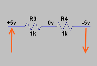

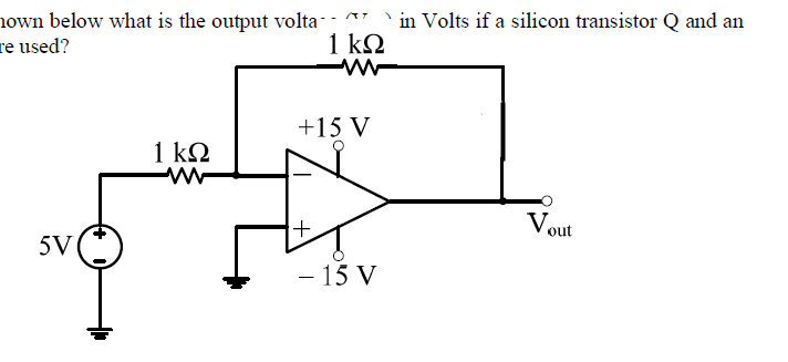

You started out with a too complicated circuit. Here is a simple one.
5V and 1k pull up on (-) input. That makes the output go down.
Balance is when the output is at -5volts.
The boy on the left is "5V" in weight.
The distance from boy_left to center is "1k ohms"
The distance from boy_right to center is the other "1k ohm" resistor.
To balance how much must boy_right weigh?

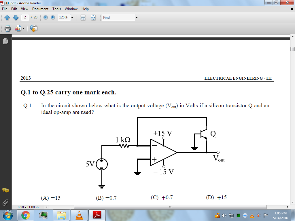

No. The negative feedback causes a gain of -1. Then with the +5V input there will be a -5V output. With no negative feedback then the output will be -13V to -14V.Ok, if there is no bjt at output then the op amp out put will be -15v right due to high gain.
Is this part right?
No. The base-emitter of the transistor is a 0.6V to 0.7V forward biased silicon diode with a current in it of about 0.5mA in it and can never go more than 0.6V to 0.7V in this circuit.Then bjt after bjt the base is 0v and enitter is -15v
Input = +5, output=-5, so the gain is -1.How you have calculated gain of -1?
