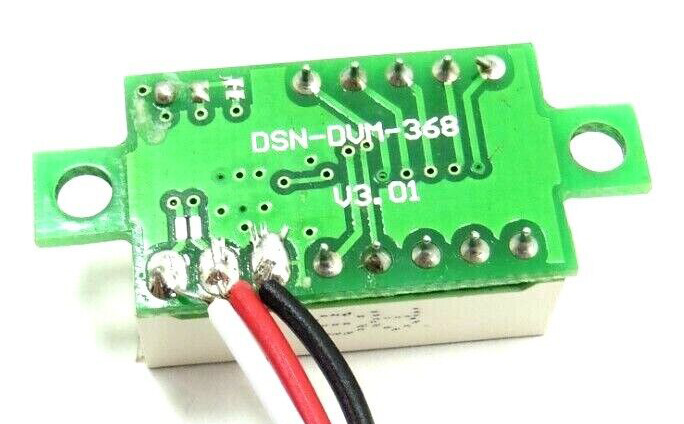

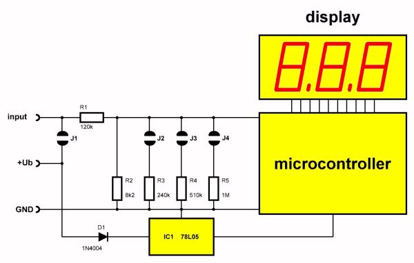

If it's a module like this:
the solder bridge jumpers at the top left connect different combinations of resistors at the input:
If you clean up the solder and use the top of the jumper position as input, that should connect directly to the MCU input, so something under 5V for maximum reading,

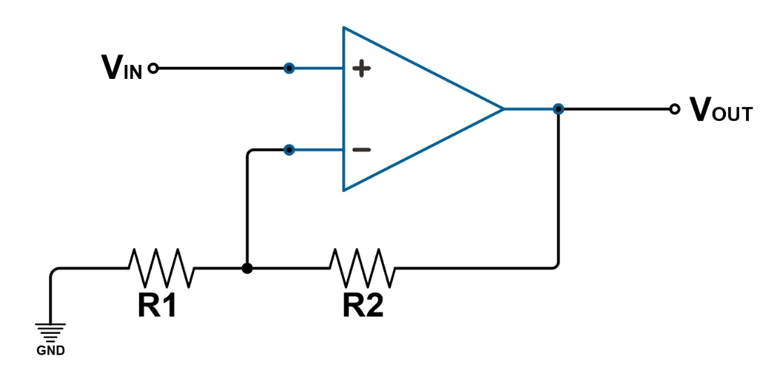

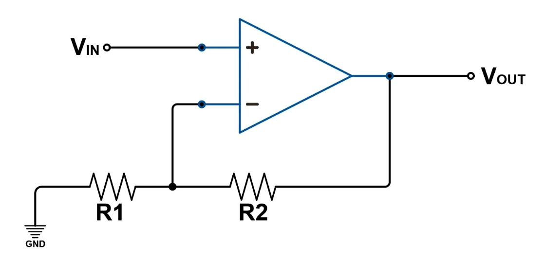

You can the then add a single supply opamp before the meter, configured for non-inverting x10 to x20 (adjustable) gain, and calibrate it to read millivolts.
eg. This type of configuration, with R2 as a preset resistor for gain calibration; possibly 1K for R1 and a 10K preset plus a fixed resistor for R2?

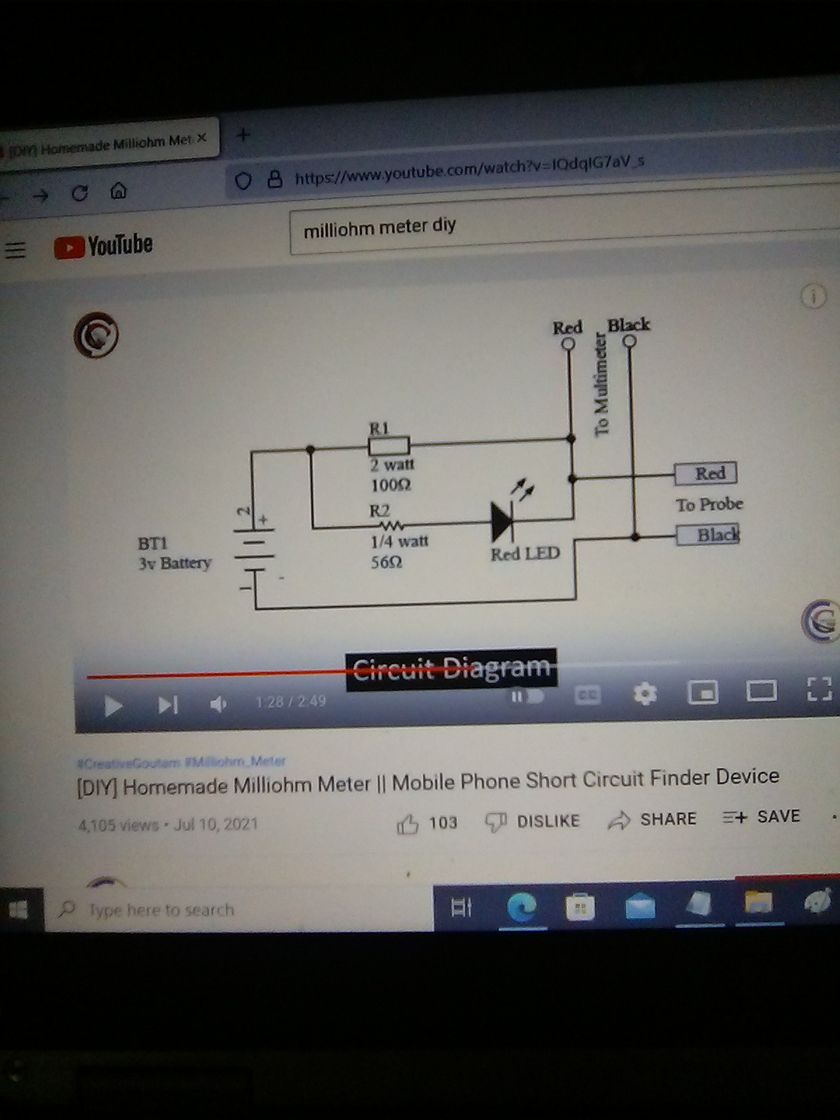

This site where found the circuit

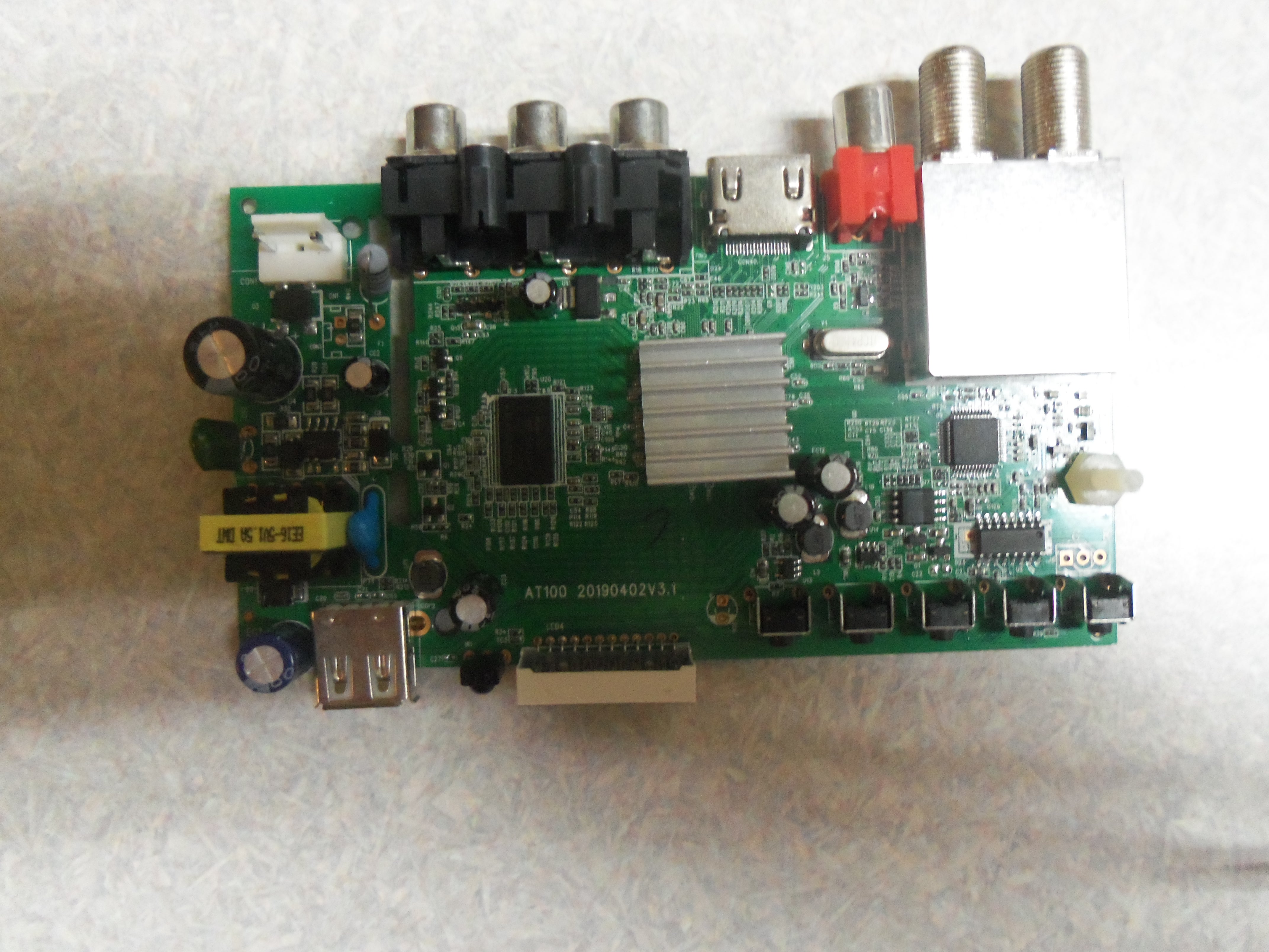

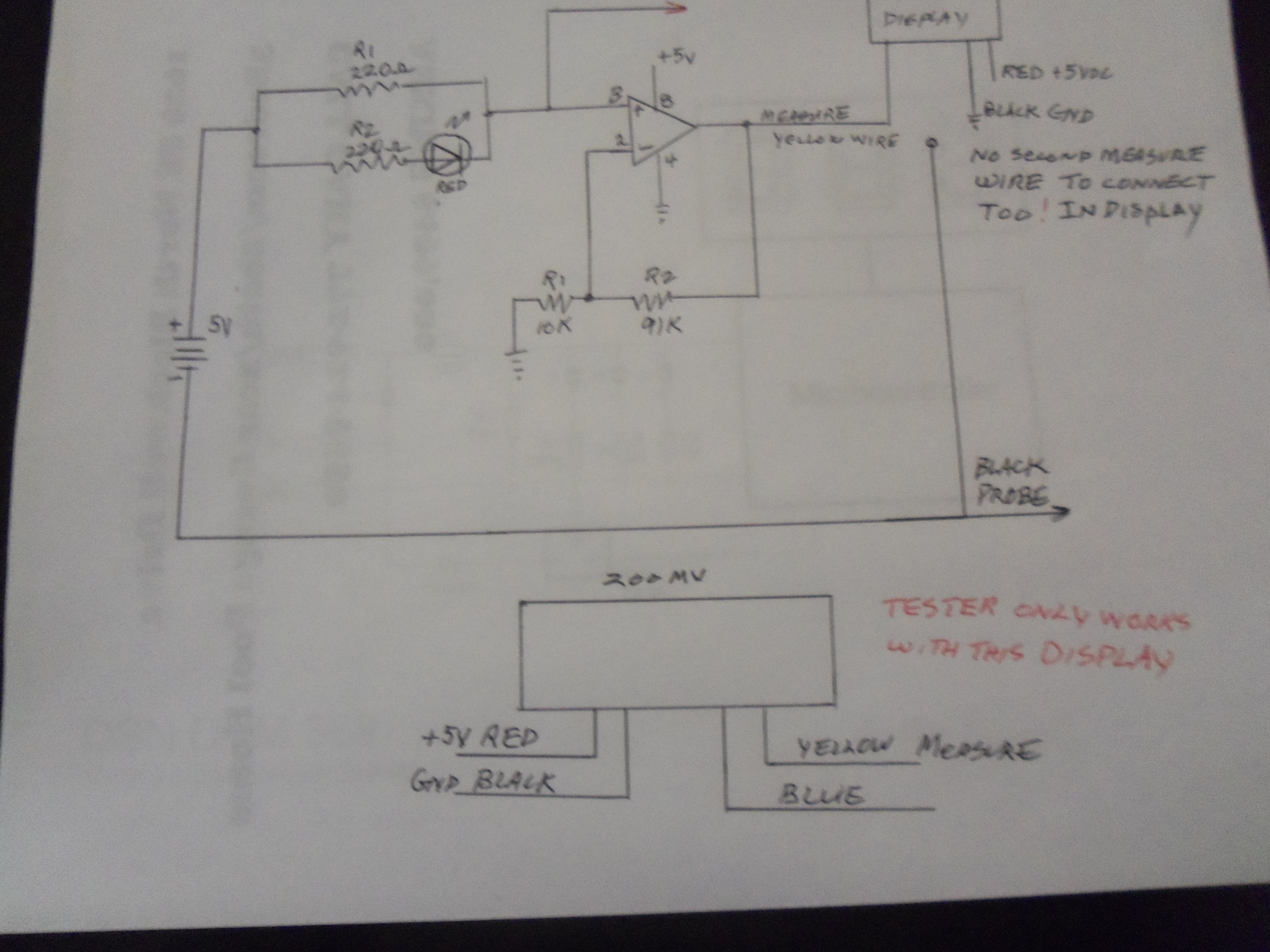

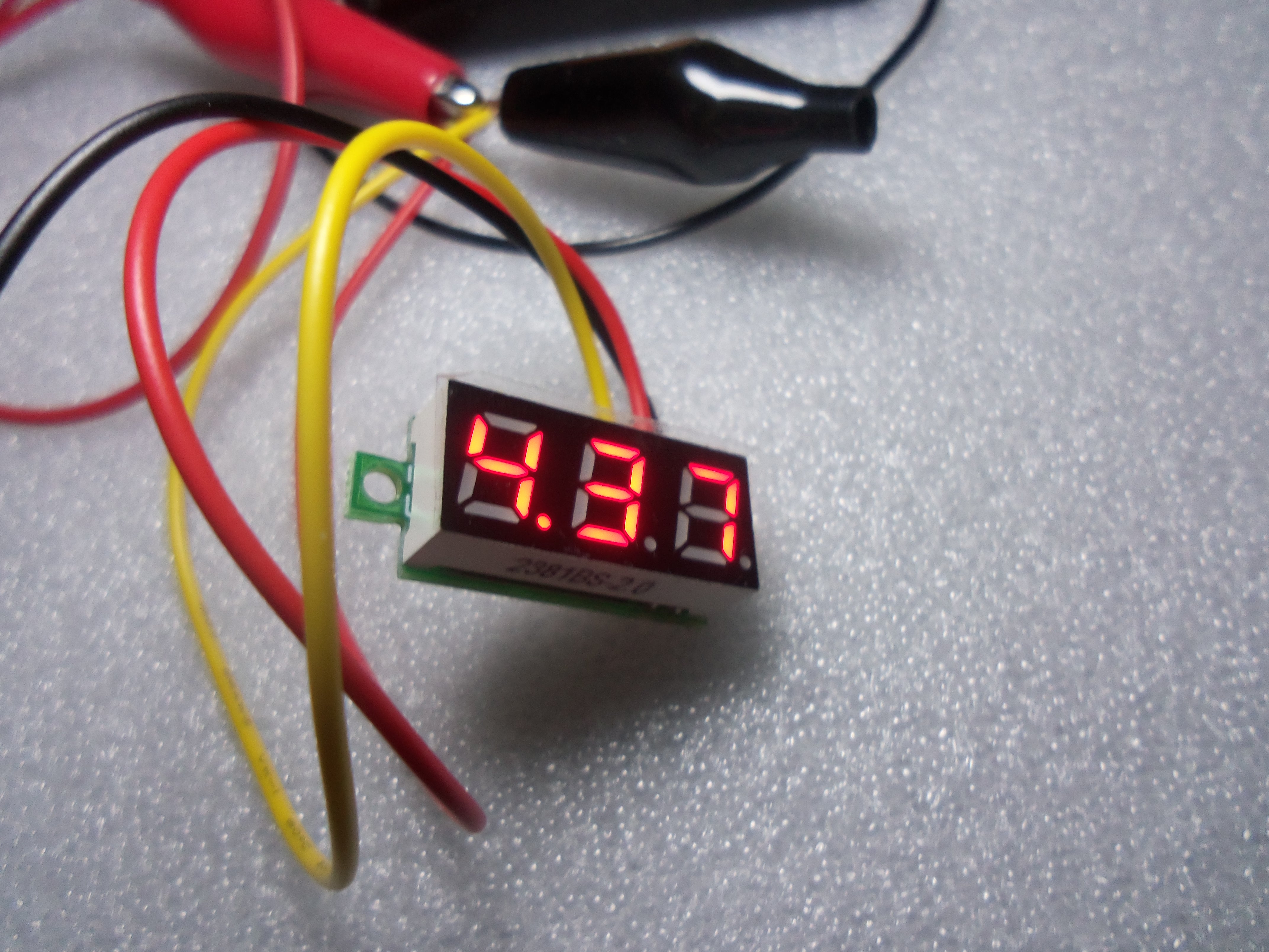

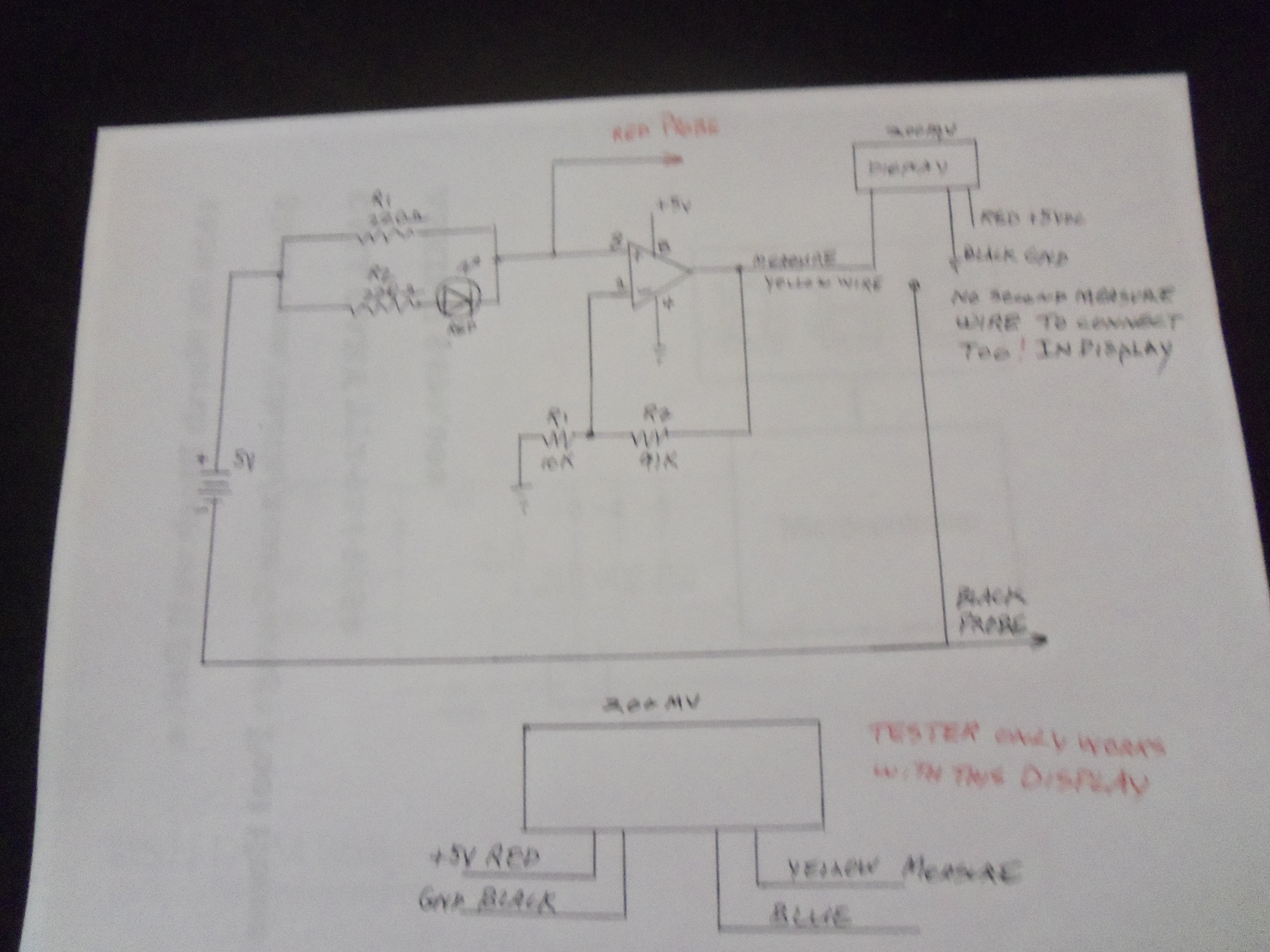

the attached file is the schematic of circuit So the way I want to use it is short probes on 200mv or 300mv meter to find the number and minus resistance that being tested. So what I wanted to use 1 ohm and 0 ohm to use as comparison. Then take o ohm I used look for reading on circuit board that are close to this number to find shorted component. I hope I explained this correctly and that's why I gave the link in post. Of course I will also use dmm to help find the shorted component. I also know you can use voltage injection and infared camera but this only one circuit board so not going go buy these. The picture insert shows the board I was working on. It's used to watch over the air tv and record to usb. I just wanted to know why it failed only using it for 2 days. It's more or less a learning expearance to find what caused failure on ciruit board. And I really liked these led digital voltmeters. So that's reason for milliohm tester.

Hi all members:

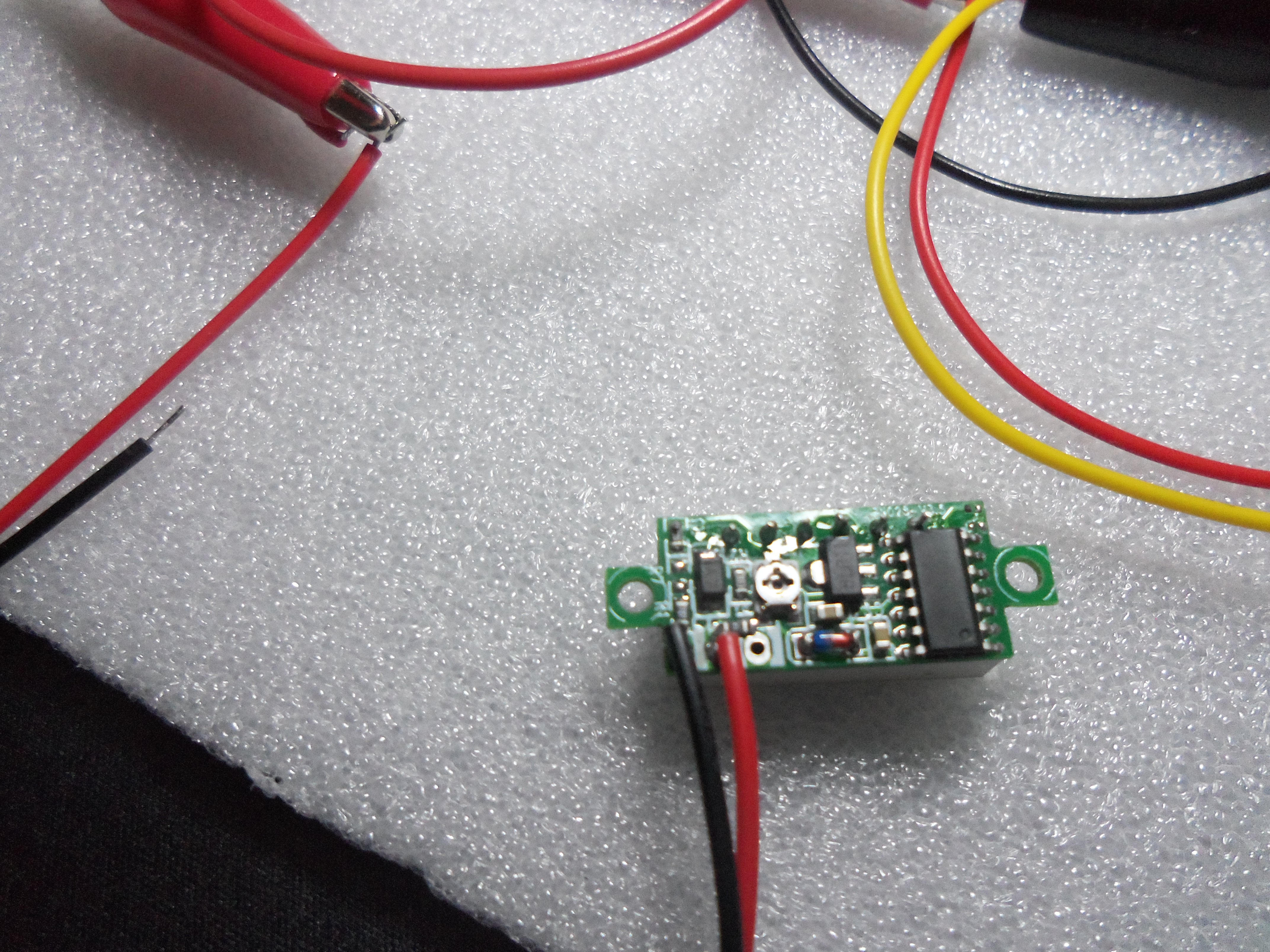

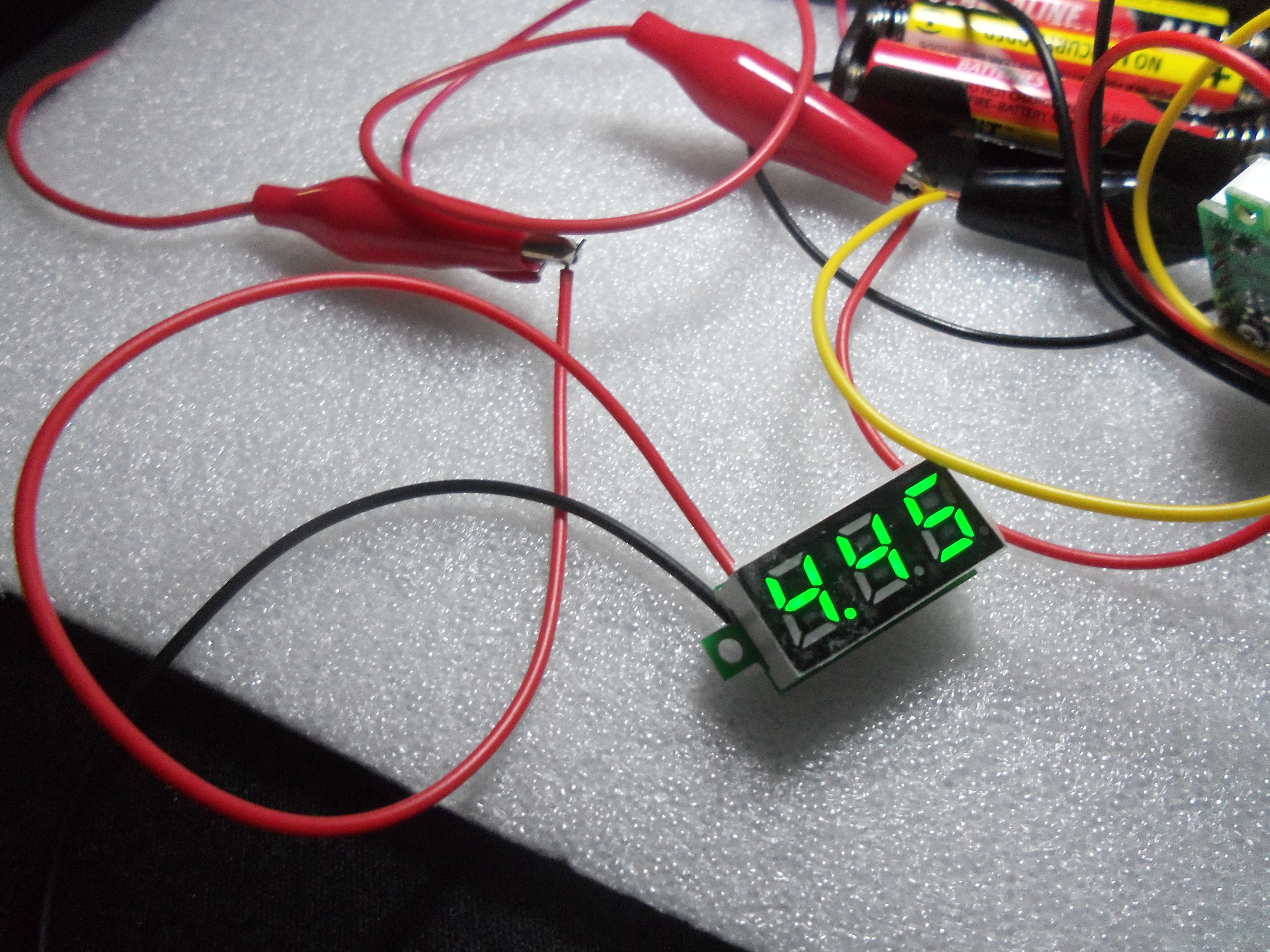

This appears where I can reply? So here is my reply See 4 attached pictures which has each display around 1" long and 1/2" wide note 2 wire shows mcu on back but use 0 ohm resistor to act as measure voltage. The 3 wire can not see mcu at all under display and same size as 2 wire. I still don't understand how to set op amp to read milli volts on this play too 200mv or 300mv full scale. Because I am only using it for resistance reading from 1 ohm to 0 ohm on circuit board. I may have to take 2 wire ckt display apart to see mcu under display. Any way this is where I am at right now. Can any one give me any more help with op amp?

Scale x10 using R2/R1= 90k/10k= 9=and Av+ = 1+ Rf/Ri
or for more resolution Av= 100 using 1+990k/10k but 1Meg is close enough.

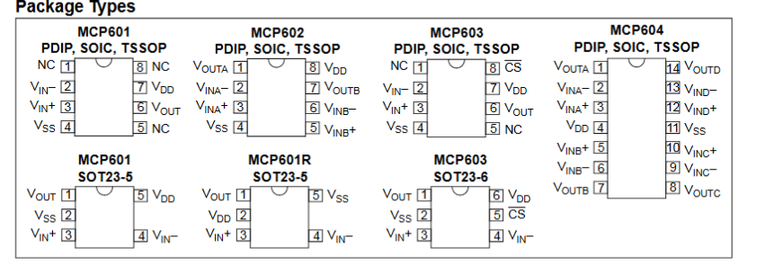

Digikey has the MCP602 for $1.26, one of the "many others" I mentioned.
Rail to rail, maximum supply 6V.
The NJM4558 is not suitable in any way, the output is not guaranteed to swing nearer than around 2V to either supply.
The MCP602 is a dual opamp with the same pinout as the 4558.
JRW I ordered 5 mcp602 . But still need to know to put 10k to gnd on unused op amp or to vcc since it still 2 op amps in one chip? Or maybe 1k to vcc or vdd on unused op amp? Which way should I do it?
I ordered the mcp602 dual opamp from different vendor digikey will not take any orders till after the new year. Can you tell me how to connect the unused opamp? Is it to ground or vcc? Should I use 1k or 10k resistor to input plus and minus ground or to vcc. Or tie the output ground or vcc through a resistor or do I do both? I read some where you should not leave the unused opamp floating in a dual package.

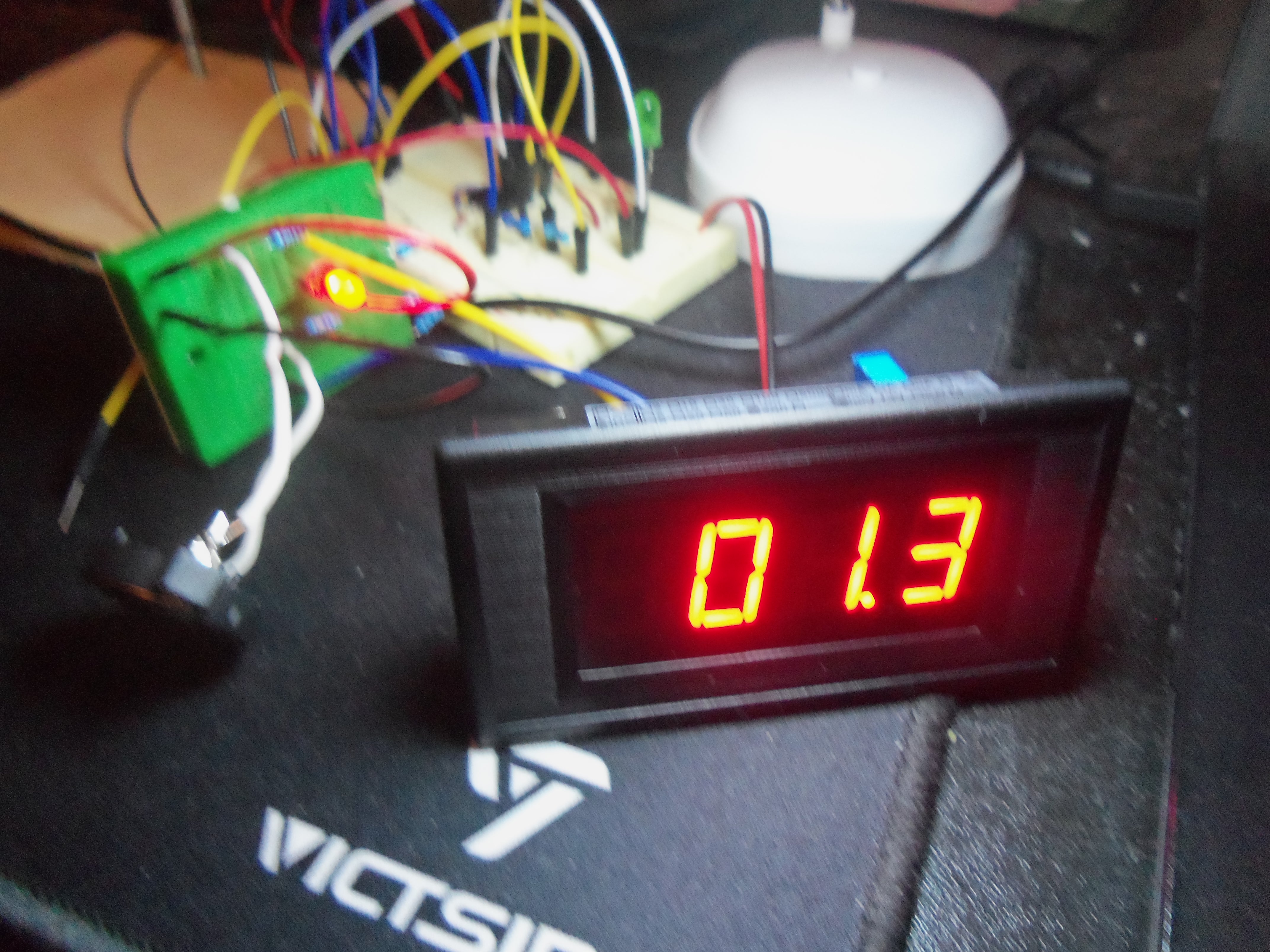

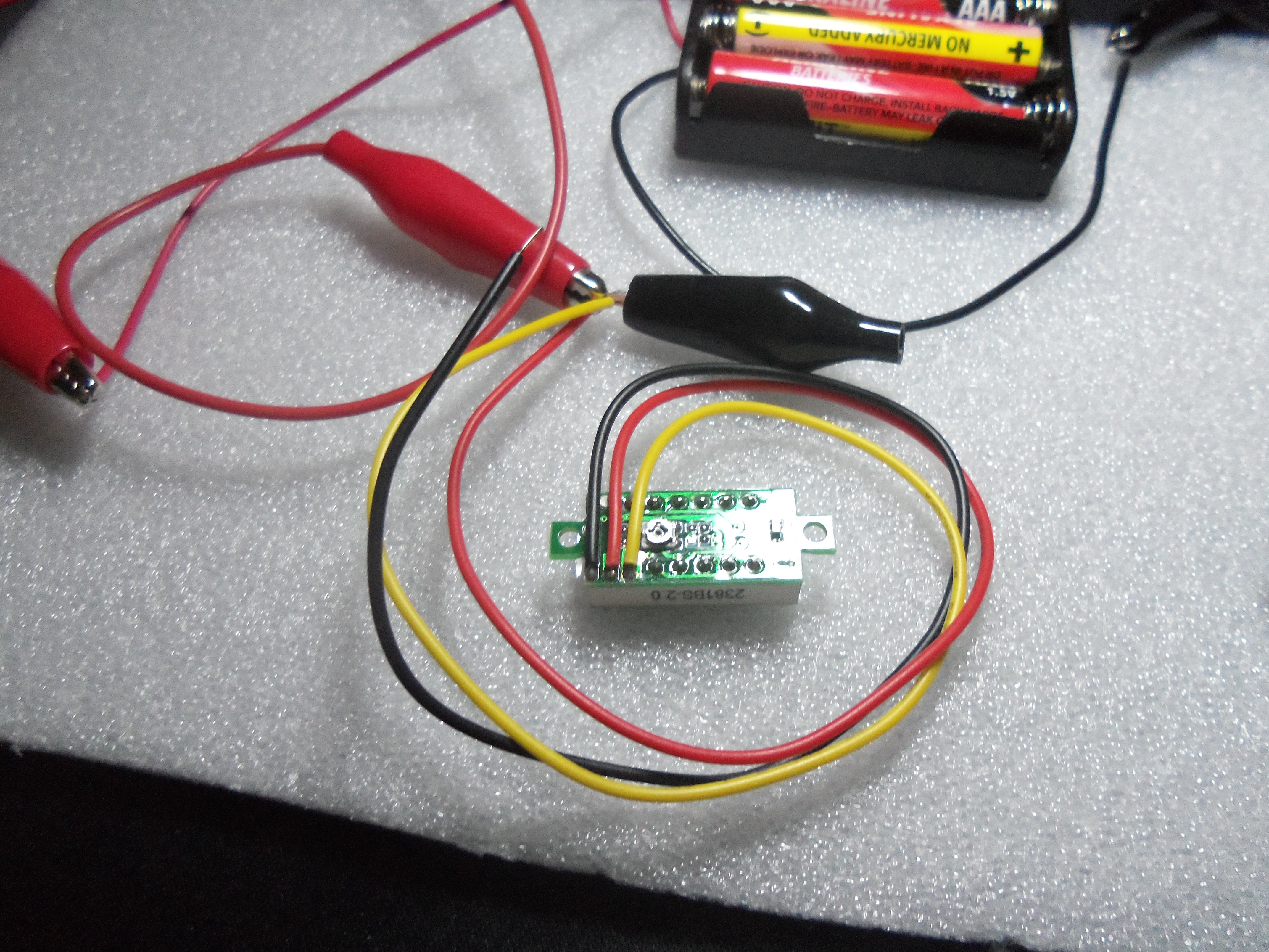

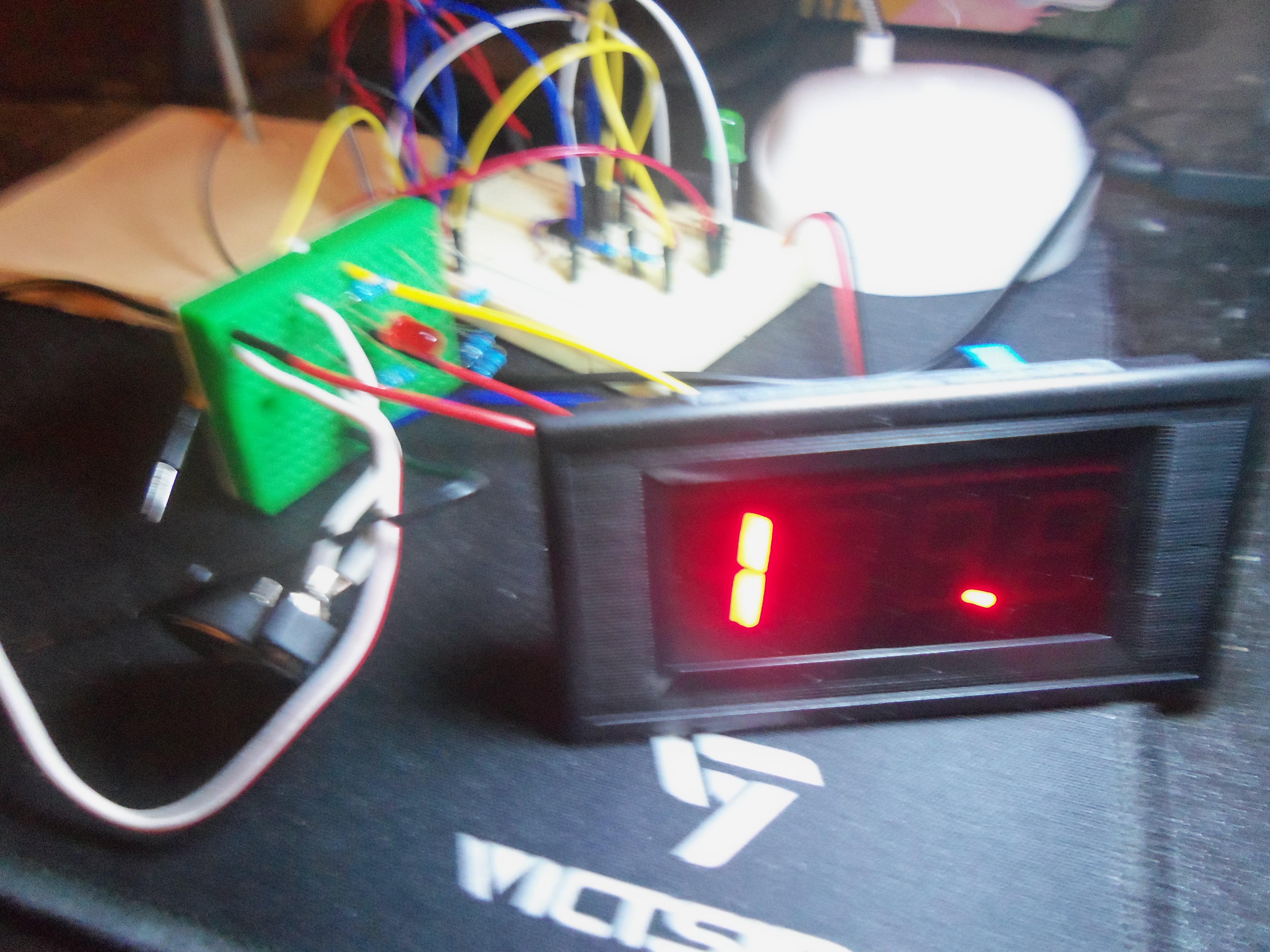

Well I have been sick for last 3 weeks , great way start off New Year. Back to my project. I did get the tester to work, but only with 200mv meter display I ordered from china. The problem I am having is the microcontroller displays don't seem to work the same as 200mv display. I included attachments of pictures of my progress on this project. The display should show a 1 in the display and when the test leads are shorted together should show numbered value and 1 shows up when test probes removed. I really like these little digital dvm's and would like unit to work using these small displays but don't know where the problem is in design of this circuit. So maybe one you men can tell me what am doing wrong or what I have do to make this circuit work the same as 200mv display meter. I am using the mpc602 op amp. The 200mv meter has 4 wires and my displays have 3 wires. If could find where to pick the 4th wire for the microcontroller would be helpful. best regards Ralph

Most of these 200mV meters cannot be powered with the same battery ground (or power supply ground) as the circuit you are measuring. One battery for the meter and one power source for the circuit.
If you really need to use the same supply, there are some tricks online using a pair of 10k resistors (if I remember correctly - Google it snd look at your options of needed).

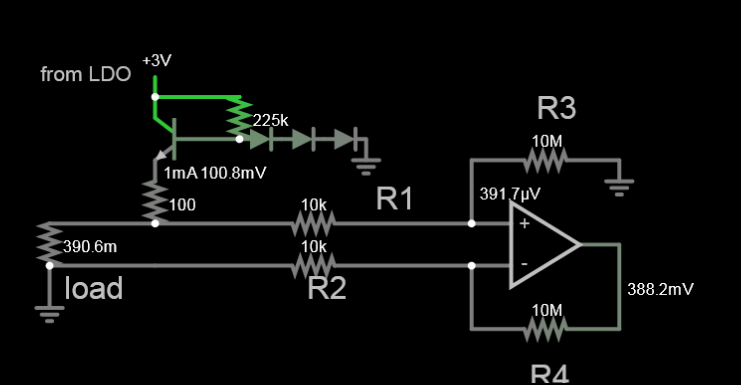

It be better to make a constant current source and read mV as 1 to xxx mOhms
This requires either 10 mA with a V gain of 100.
or 100 mA with V gain of 10.
What are you using for power? Lipo? 3V LDO?
Select pin #'s from the proper package
Simulation accuracy depends on tuning Rb for differences in hFE=100 (there are better ways) and matching R3/R1 ratio = 100 = R4/R2
Depends on what you want. This is 1mV / mohm using 1mA constant current.
