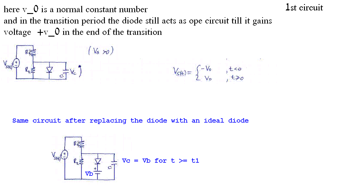

how the diode will act in these situations in transition period
How accurate does it need to be?
The simple approximation is to simply subtract the typical forward voltage drop from the power supply then perform the normal RC transient calculation.
The more precise is to use the diode equation in conjunction with the RC transient differential equation. My maths isn't good enough to work it out so I'd turn to SPICE for help.

In circuit 1 you have to figure out the initial capacitor voltage
for when t<0, and that shouldnt be too hard.
Then you have to find the time response up to the point where
the diode conducts (sometime after t=0) and then the diode
acts as a voltage 'clamp'. When the diode acts as a voltage
clamp, it looks like an ideal diode (no voltage drop) in series
with a small battery equal to the voltage drop v_0 with the (+)
terminal connected to the cathode of the diode.
In circuit 2, the diode is probably the same as in circuit 1, where
it drops v_0 volts. The only difference here is that if it drops
v_0 volts then it will affect the step response by subtracting
v_0 voltage from the source.
In the following drawing, Vb=v_0
It will be short circuit, unless you consider it to be like the diode in the
first circuit when then it will drop a voltage equal to v_0 volts.
For example, if v_0=0.7v then the diode will drop 0.7 volts.
This means 0.7v will be subtracted from the unit step input.
If you consider th diode to be totally ideal, then it will not drop any
voltage.

For the first circuit...
For the time between t=0 and t=t1 the diode is an open circuit.
It is open until Vc comes up to equal v_0. This means you
have to solve for the time t1 when this happens.
Since Vs=-Vo for t<0 that means you have to first solve
for Vc(0-) and then take it from there to solve for t1.
Keep in mind that in that drawing v_0 is not Vc(0), it is
the diode drop (assumed to be constant).
If you need to see the math let me know.
[2]
For 1st circuit, you have to solve for Vc and since Vs=-Vo
then the voltage on the cap will be the voltage as if the
diode wasnt there. When Vs goes positive, the cap starts
charging positive and you then solve for t1.
For the 2nd circuit, we assume Vc(0)=0, and for the unit step
the peak voltage is 1-Vdiode, and so instead of the unit
step we have (1-Vdiode)*u(t), which is less than u(t).
For the impulse source however, the diode is insignificant even if
it has a voltage drop, so the diode is a short for the impulse
source. It will also be a short for the unit step response too
but only if you consider the diode voltage drop to be zero (ideal diode).
For the first approximation diode (vdiode=0.7) we would end
up with a 0.7v voltage drop, for example, so the source would
be u(t)-0.7 which is 0.3*u(t).
For the impulse source, delta(t)-0.7=delta(t) which is no change.
Note that in the 2nd circuit there is a postive voltage on
the diode at t=0+ because the unit step or the impulse puts
it there immediately and the cap voltage is zero.
