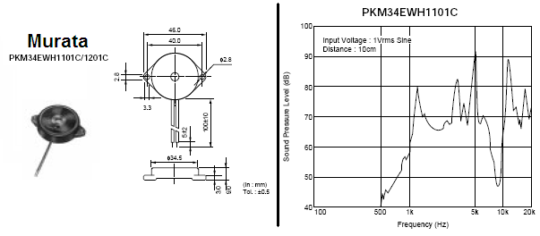

Here is the frequency response graph of a name-brand piezo transducer (speaker, not beeper).
Its level is all over the place due to its strong resonance at 5kHz and smaller resonances at other frequencies. Look at the notch at about 8.5kHz.
Its outout drops 20dB or more just a few hundred Hz away from resonance and the output below 1kHz is almost nothing.

Piezo ceramic is made by static charge polarizing polycrystaline ceramic. It is the electrostatic equivalent of charging a magnet. Usual chargng field is about 4 kV per mm thickness of ceramic.
When electrodes are place across the polarized ceramic is will compress or stretch depending on applied voltage relative to polarized direction. As with most mechnical devices there will be a resonance point that will create a conservation of energy resulting in a build up in the physical excursion.
If the resonator is placed in a highly dampened environment (acoustical coupling) the the resonator will de-Q. You get less excursion but wider bandwidth. This is what most medical ultrasound imaging machines do. They operated at a loaded Q of 1 to 2 versus unloaded resonator Q of about 30.
You can make a low frequency ceramic piezo transducer. It is just a matter of size and mix of ceramic. Anyway, in your application creating water droplets it is likely pretty well dampened. Just about all ink jet printers use piezo transducer to 'spit' out droplets of ink.
As to audio amps, most will be okay with a high impedance load. Some without a minimum load may have high frequency oscillation. Put a 20 to 50 ohm resistor in parallel with output and you should be fine driving the ceramic transducer.
As a side note, if you apply excessive drive you can depolarize the ceramic causing the piezo properties to degrade or disappear. This will start to happen a about 200 volts per mm thickness of ceramic. (for most ceramic mixes).
