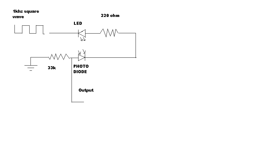

i have attached the image of my circuit ...............
in normal conditions it gives proper output as expected ...........
but when i take this circuit near the lamp output gets DC shifted and the output square wave is totally clipped ...................
so i want to reduce this DC shift and want to get the square wave

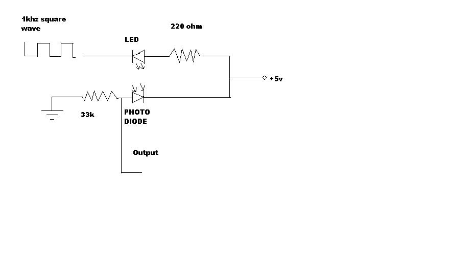

You forgot to draw the power supply; I'm assuming it's 5V. The 33K resistor is a little on the large side. Try 4k7 or 1k (this will reduce the output swing however). what values have you tried already?
the photo diode i am using is like a LDR (light dependent resistor) .
Its resistance decreases with the increase in light following on it.
so when i take the circuit near the lamp, resistance gets nearly zero so output voltage which is across 33k resistor becomes 5v.
so i think there is no need to change the value of resistance.........
