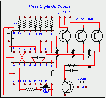

i found a counter in Laurier's page... it's quite suited to my needs... thanks a lot guys! anyway, just have a little difficulty in multiplexing the 3 7-segment displays...is it right to connect the collector leads to ground and pin 6(dp) of the 7-segments to ground? the circuit is attached...
thanks again!

You did not specify the ICs, so I don't know what pin 6 does.
It is evident that the 7 segment decoder outputs the high level and so the multiplexing can be done with PNP transistors with their collectors connected to gnd as shown. But again, you did not specify the counter IC so I can't be sure.
