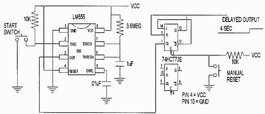

The 555 timer will give a delay but the problem is that the output is low until the start switch closes then the output goes high for the delay time and goes low at the end of the delay time. The solution is to use a flip-flop that changes state on the falling edge of the clock. In this circuit, the output goes high 4 seconds after the start switch is closed.
simple time delay
