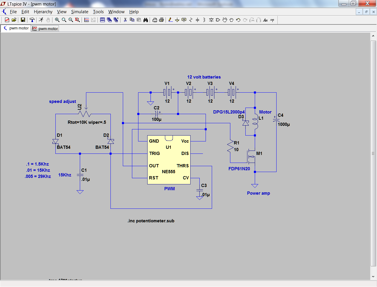

Yes, will need to start under load; it is an electric quadricycle I built with 2 joined bicycles and now am tackling the PWM. Open cycle, less than 1 HP. If not enough power, will add more batteries (all riding mower Pb type) later.

Then your controller will need to be rated at 120 or 130 volts.
Here is a cheap and dirty circuit you can use. I put some cap values in if you want to try various pwm frequencies.
The FET and big diode will need a heat sink
