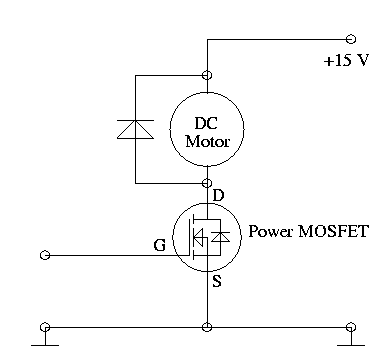

How I can choose the correct freewheeling diode for PWM control 25A DC Motor.
How do you choose the current rating of a diode.

If you are switching the motor On/Off, the current flowing in the motor at the moment you switch OFF will be the required Diode current peak rating.
For a 25A motor current, you use a diode with a peak 25A rating.
Do you mean this peak current form dataset Peak forward surge current, 8.3ms single
half sine-wave superimposed on rated load
I would select a diode with a 25A average rated load current.

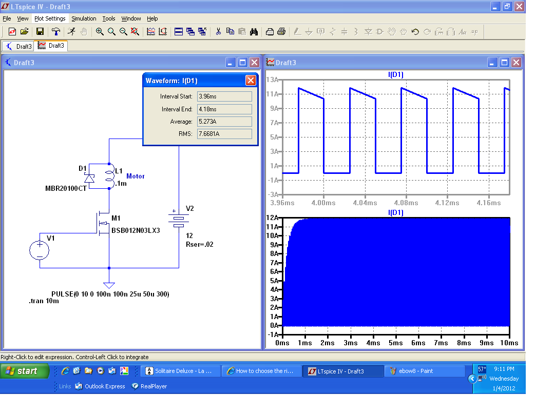

How about somewhere in the middle? Say 10 amps with a heatsink.
i guess that really depends on the mosfet used..... the lower the Rds-on, the higher the diode current.
I think the maximum diode current occurs at a 50% duty cycle and high motor inductance. So a 25 amp motor will store 12.5 amps. Since the diode will see the same current during fly-back it will see 12.5 amps but only for 50% of the time or 6.25 amps average. Higher duty cycle will produce diode peak currents up to 25 amps but for only a very short part of the PWM cycle. There may be some reverse recovery time currents but with a schottky diode they can probably be ignored for this discussion.
