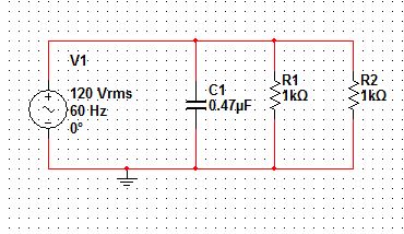

So in trying to learn how to quickly compute the impedance of parallel resistor combo:
using the impedance for a capacitor Xc=1/(2*pi*f*C), with
C = 0.47uF
R1 = 1k
R2 = 1K
f = 60 Hz
Seems like I should have a total impedance value of 459 ohms. But running the simulation gives me a much different value. Can anyone tell me what I should get with this circuit?

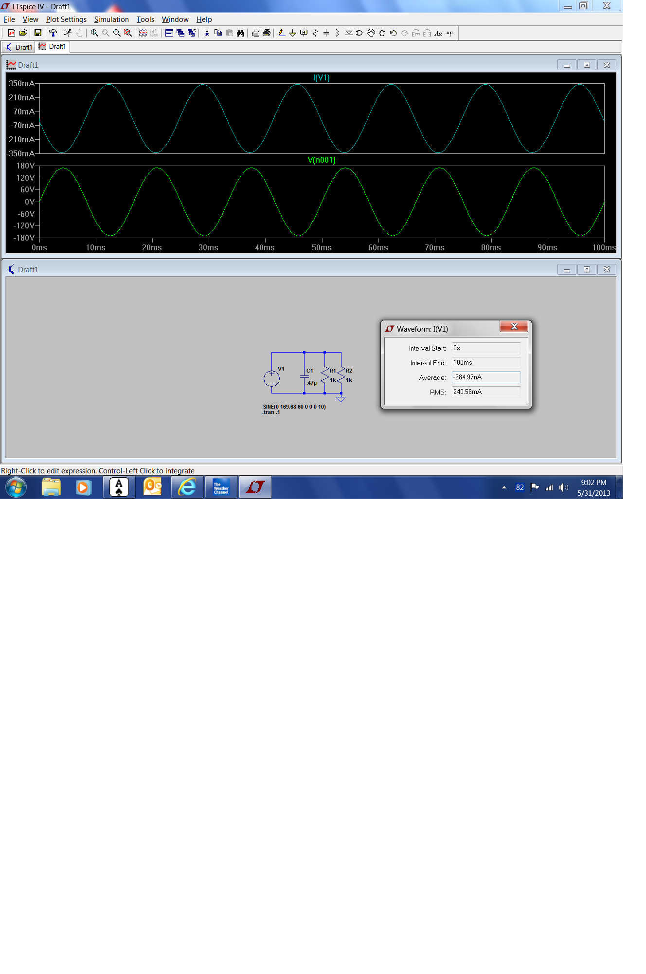

im computing impedance here, so the amount of voltage shouldn't really be taken into consideration right?, only the frequency is used from the voltage source. I mean if I did just resistors with a DC source, voltage doesn't really come into play when measuring total resistance.
Also Im getting values of 14-17kOhms, much higher than 1.41x the computed ~500 ohms.
and if anyone cares, here's how I computed the impedance.
First I found the impedance of the cap @ 60Hz, so
Xc = 1/(2*pi*60*0.47*10^-6) = 5.64 kOhms. As all three passive components are parallel to each other, I computed this as
1/[1/5644 + 1/1000 + 1/1000] = 459 ohms.

No idea how multisim is getting values in the 14-17 kohms range, which is way too high.
LTSpice likes Mr. Al's number. Maybe it is just multisim.

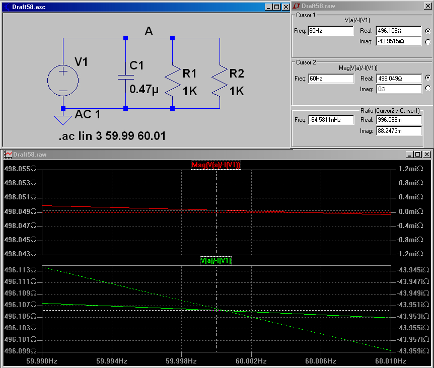

Here is how to get LTSpice to show you the complex impedance numbers directly. Same circuit, except I used AC analysis. I forced it to compute the AC values at just three points, 59.99Hz, 60Hz and 60.01Hz (.ac lin 3 59.99 60.01)
Now we want the impedance of the network which is the voltage at node A divided by minus of the current through the source. So when you see the expression (V(a)/-I(V1)), think impedance, Z.
I used two LTSpice plot panes set to Cartesian mode (as opposed to Bode mode). The upper one shows a Plot of the Magitude of the complex impedance, which in LTSpice's Plot arithmetic uses the Mag() function, so I plot Mag(V(a)/-I(V1)). Ignore the red dashed line which would normally show the imaginary term which is zero by definition. The cursor shows that Mag(Z) is 498.049Ω at 60Hz.
The lower plot pane shows the Cartesian version (Real and Imaginary parts separately) where the solid green line is the real part, and the dashed green line is the imaginary part. The cursor shows that Re(Z)=496.106Ω and that Im(Z)=-43.9515Ω
Not bad for a free program, huh?
