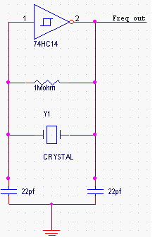

Try this circuit, if you dont have 74HC14 you can use any inverting HC gate...
But doesn't the caps depend on the crystal frequency? I wasn't able to find any datasheets.
Cheers!
Lac.
It depends but in wont cause the crystal not to vibrate, 1Mhz-40Mhz crystals should work with those capacitors that i gave you.
If you still don't get any frequency chack that you gave the logic gate VCC and GND !! sometimes it is forgotten by beginners.
Your crystal might damaged, try to replace it.
