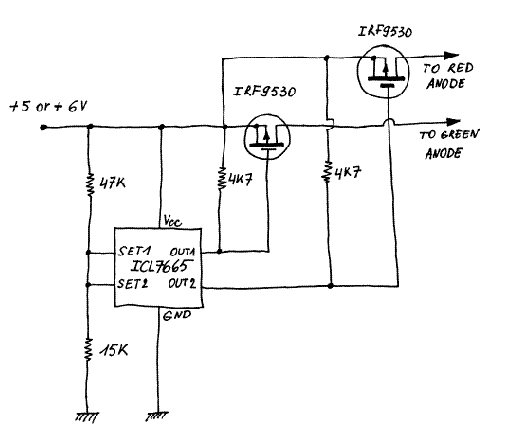

Hi Hiker,
Check this out:
https://www.intersil.com/cda/deviceinfo/0,1477,ICL7665S,0.html
You can use a ICL7665S to switch between to different
voltege levels: +5volt for the red anode(s) and +6volt
for the green anode(s). There are in fact two level
detectors and both are set to 5,5 volt which means
that around +5,5 volt both may be on or off but that's
no real problem because you switch from +5 to +6 volt.
There's no need to calculate a hysteresys because it
will only complicate the circuit and it's not really
necessary.
The highest voltage output will be connected to the
green anode(s) because the voltage drop across the leds
of the green display will also be higher. If this is not
enough to get the same brightness with the same cathode
resistors you can increase the voltage difference even
further. e.g. +5 volt and +7 volt. You only have to
recalculate the trip point for +6 volt.
The fets are old devils and you can use almost every old
mosfet you can get on condition that the maximum drain
current will not exceed 500 mA at +5 volt supply voltage.
on1aag.

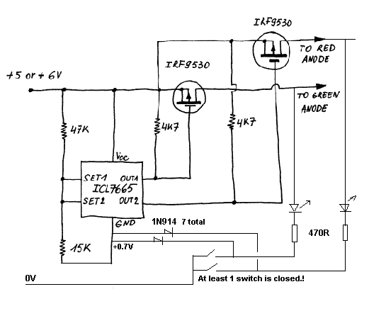

hi on1aag,
If I have followed hikers description correctly.?
There is no 0V return from the displays,
just the 7 lines from the cathodes of the segment LED's going to the manual switches [back at the psu], then to 0V.
Perhaps hiker will confirm this.?
Hope you are well.:)

Eric you have it right. The 7 cathodes are connect to the cat5 wires which, on the other end, are connected to the 470 ohm resistors at the other location and then to ground.
I suppose I could move one of the 470 ohm current limiting resistors to the display location and connect that wire at the other location to ground. That would give me 0v at the display location.
hi hiker abd on1aag,
on1agg,, Modified you circuit to give a virtual ground for the ic, what do you think.?
Only two LED's shown for clarity
Hi Eric,
It's a possibility, but I'm not convinced that it will work
equally well unless you select the two supply voltages
further apart.
on1aag.
on1aag or eric,
Thanks. I just wanted to confirm the resistor values as these old eyes are having a hard time reading the diagram:
upper left 47K
lower left 15K (not sure about this one)
The other 2 are 47K I think but diagram looks to have 4K7 ?
Also what voltage appears at the red and green anodes, 5 or 6 v ?
And could I use 4.5v and 6v instead of 5v and 6v ?
Looked at datasheet for irf9530 and not sure which of the 3 leads correspond to the diagram ? They are labeled S G and D.
Hi Hiker,
The resistance values need not be recalculated for 4,5 and 6 volt.
47k, 15k, 4k7 and 4k7.
The highest voltage goes to the green anode(s).
Both sources of the fets are connected to the supply voltage,
the gates are connected to the outputs of the ICL7665S and
the drains go each to a anode of the display.
on1aag.
