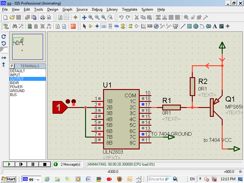

Hi, i have an oscillator circuit that i'm using for a project
i built this circuit after so many various tires to control power to the oscillator circuit (a pierce oscillator)
However, it doesn't seam to work fine.
The trigger input is coming from a microcontroller, when i test the circuit with a scope, it seams to work,cos as i set the input high, the oscillator waveform is producted, when i set it low, it goes out.
but inside the main circuit, with the input triggered by the microcontroller, it doesn't work, except i connect the power directly the VCC what other method can i use to control
ive attached the schematic of the design
thank you.

A ULN has a Darlington type, open collector output.
When you pull 0V to the 7404 it will only pull to approx 1.5V.
Why do you need to switch the 0V as well as the +Vcc to the IC..??
Also what are the resistor values on the pnp.?

Post the circuit that you are trying to control.
I think it may be that there is nothing to "pull" the output of the transistor to ground when it is turned off. Add a resistor to ground there.

I would advise not to switch the 0V [pin7] of the 7404, leave that connected to 0V.
You should drive the pnp transistor into saturation in order to give the maximum voltage to the 7404, [pin14]
