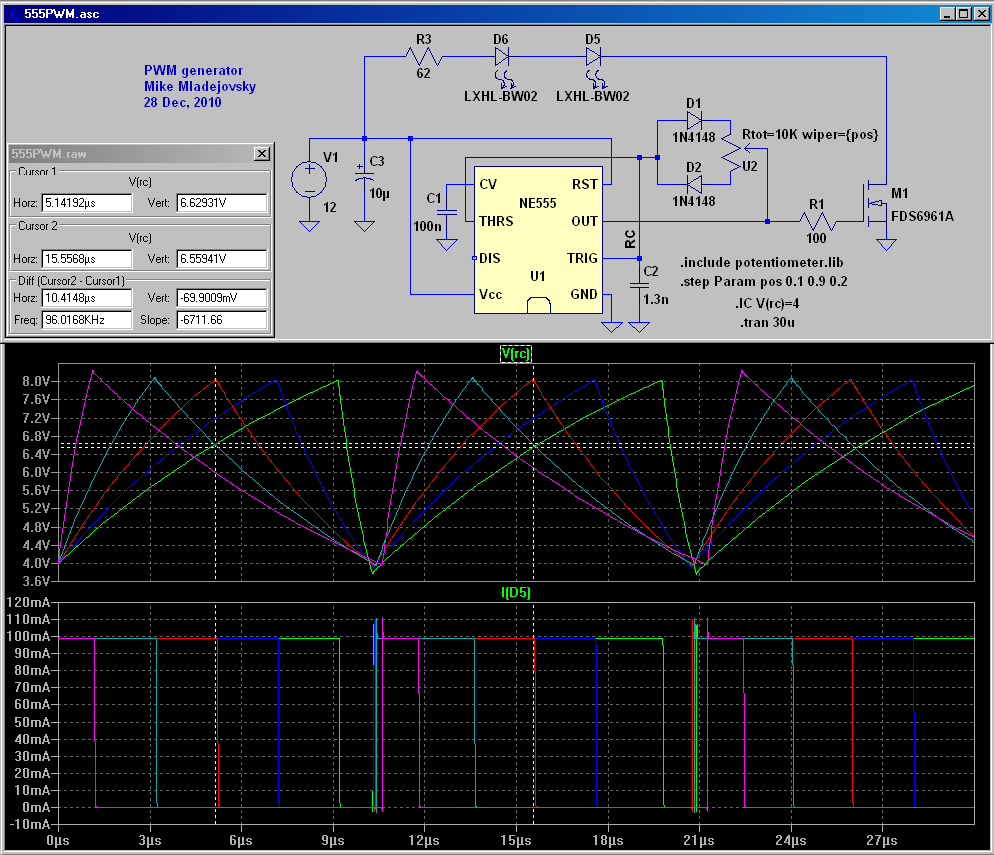

Here is my suggestion. The frequency is nominally 95kHz. It varies slightly as the duty-cycle is varied. As shown, the current through the LEDs is ~100mA.
