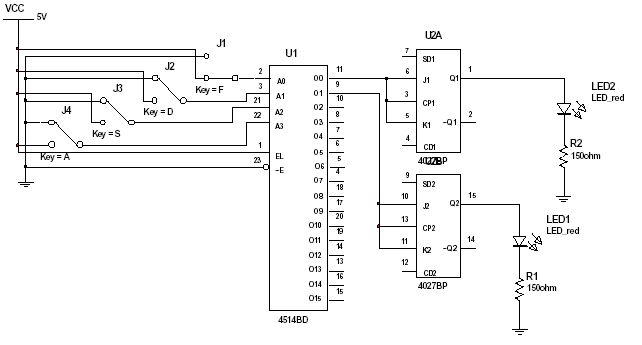

well it depends on how you want to control them. if you just have one led max turned on, then you would need somthing like 8 to 128 decoder, or 8 to 256 decoder.
but if you want to have more than one led turned on, then you could use a flip flop for each led(250?!) so than it wil require a pulse to turn on the led and one pulse to turn it off.

I was going to build the same thing a while ago but never actually built it. I’m not sure if is the easiest way to do it but it uses easily obtainable parts.
As bogdanfirst said if you use a decoder then the decoder can only address one led at a time, which makes for a pretty boring project. So you can use flip-flops to give the leds a sort of basic memory. But it does mean that you need a flip-flop for every led. Once the decoder addresses the specific led then the flip-flop will toggle and what ever state it was (i.e. on or off) it will change to the opposite.
So if you want to turn led number 8 on then you simply pass the number 8 into the decoder through the parallel port of the computer which is connected to the decoder. The decoder will then send a high signal to the corresponding flip-flop. This flip-flop will then change from a low to a high output (assuming it was originally on low). To turn the 8th led back off you pass another number to the decoder to make the input of the flip-flop goes low (the led will still be on) and then address the 8th led again causing the flip-flop to toggle and change back to low (or off). I hope that wasn’t too confusing.
I quickly made the schematic below but it is not complete, I have only put two leds on the decoder. Your version would probably have a larger decoder and a flip-flop led pair on ever output of the decoder. I also don’t know what flip-flop or decoder you should use, these ones were just the first ones I found in the parts list, maybe someone could quote some specific part names that could be used.
Please ask if you need any more help of if you are confused on how the flip-flops or circuit works.

250 LEDs ... Are you sure ? Why not 256, it would be a whole lot easier...
You have no idea how badly I want to tell you to just get up and turn the light switch on, it would be a whole lot simpler :)
Actually, it should be 255, as you need to reserve one of the states as the all-off state :lol:
Anyway, the idea as others have mentioned, is simply cascade decoders to form 8-256 decoder to turn on any single LED. Cycle through the ON-LEDs to get a virtual effect that multiple LEDs are lit at the same time.
