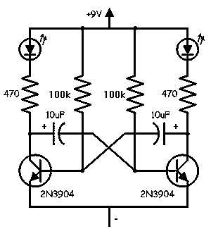

I am wanting to turn a 2 LED flasher into a 3 LED flasher. i have attached the current circuit drawing. Could anyone explain to me how this could be done if it is even possible?

That circuit flashes the LEDs alternately. Essentially it's an astable multivibrator.
For 3 LEDs you'll need a different circuit. What flashing pattern are you looking to do?
You could use a decade counter like the 4017 to flash 3 (or up to 10) leds sequentially.
