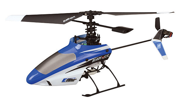

I have a small 4-channel RC helicopter, the Blade msr. It weighs 1 ounce (28.3 grams) with battery.
It has a single main rotor (7" diameter)and a small tail rotor like real helicopters.
It has a gyroscope circuit that makes it easy to fly because it goes in a straight line or hovers without moving when you center the controls.

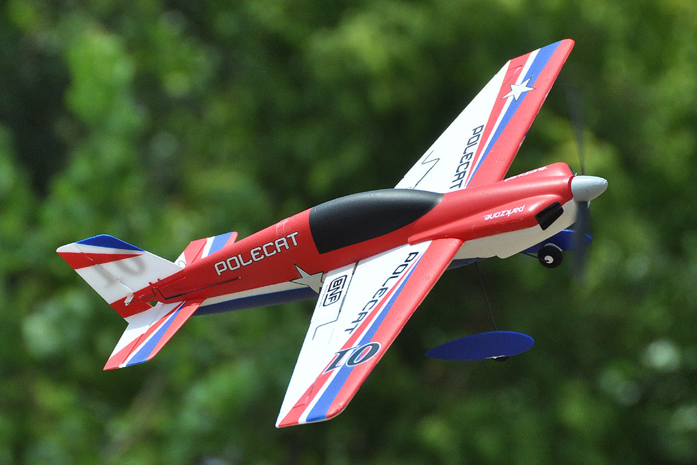

I practised flying airplanes on two Microsoft Flight Simulator programs. My RC airplanes fly completely different because they are small.
Hand launch your RC airplane vertically so that you can practise manouvers up high without the ground jumping up and smacking it.
Here is my latest little RC airplane (16" wingspan) that has more thrust than its weight:
