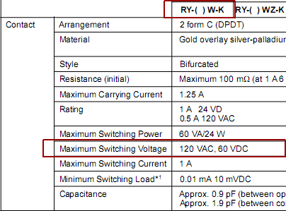

i got a relay RY5W-K i wand to drive small currents at high voltage
(small lamps 5-10 Watt at 230Volts AC from wall plug)
their datasheet - > **broken link removed**
from the store they told me that i can connect 230Volts AC
but in datasheets sayng max voltage 0.5amp @ 120Vac
they inform me wrong or read datasheet wrong ?

but in datasheets sayng max voltage 0.5amp @ 220Vac
I read the data sheet as 120Vac.?
Where do you read 220Vac.?:)

means 120 corrected
In that case its not suitable for 220Vac.:(

What exactly are you going to control with the relay contacts.?
not somethink specific
small lamps , or small home appliances
but directly from wall plug
Relays like this would be suitable.
