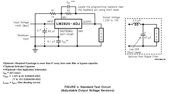

You'll also need a couple of caps as shown in the schematic at the end.

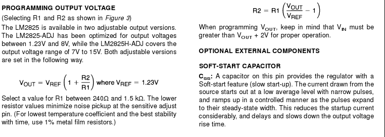

The better way is to use the circuit on page 7 of the data sheet, and make R2 a variable resistor. R1 is fixed. That way the adjustment goes from 1.23V up to whatever maximum you want (using the formula on that page) and it will be linear.
To use a potentiometer as a variable resistor, just connect to the wiper and one end. If the voltage goes up when you turn it down, connect to the other end instead.

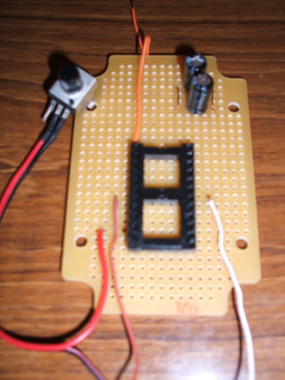

This is a photo of how far I've gotten.
I bridged and soldered together the IC's pins as directed by the PCB layout.
The orrange wire comes from the IC's GND back plate.
The brown line just to the left of the IC holder is the output.
The white line to the right of the IC holder is the input.
I have connected the potenentiometers wiper (red wire) to the IC's ADJ pin No. 10
The two input caps in parallel at the top are currently isolated from the rest of the circuit.
Where do I connect the input +, - power lines to? :confused:

Do I need to connect a resistor, R1 in to the potentiometers R2 GND connection? How to I work out the value of the resistor to use? The IC that I'm using is the (LM2825H-ADJ) version which has been optimised to produce 7V to 15V.

A view of the other side too please.

As you are using the potentiometer as a variable resistor, there are only two connections that should be made to it.

I have two wires already connected to the potentiometer. A red wire that connected to the wiper. I have connected this wire to the IC's ADJ pin No 10. I also have a black wire connected to one of the potentiometers output legs. However I'm unsure where I need to connect this wire to.

I assume that connect the positive power wire to the IC's input connector and the potentiometer output leg to the IC's output connector. I'm not sure where I connect the negtive power wire or the IC's ground to though. :confused:
Well it's a buck converter, it'll only give you 12V out if the input is greater than 12V. A buck/boost converter will work with a input lower than its output.
The pot is wired as follows: GND, wiper to ADJ, OUTPUT
Why didn't you just buy the 12V version of the IC?
