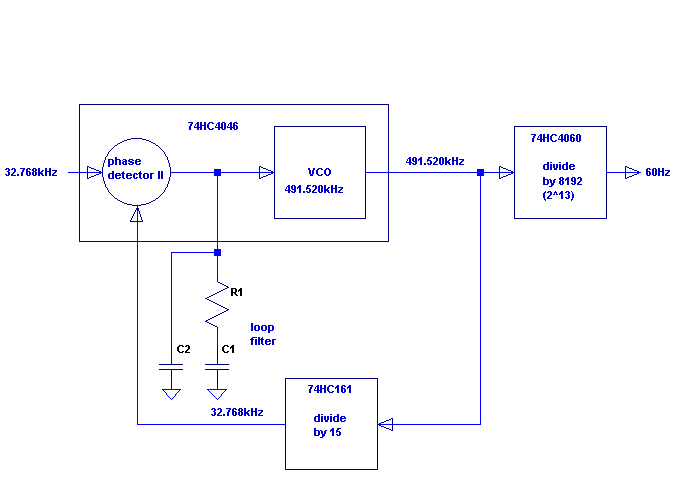

Here is a block diagram of how to do this with a hardware Phase locked loop (PLL).
Thanks! Should be able to put this to work. Any sites with info on this setup? What are those caps and the resistor for? How do I know their values? And one last question, how accurate will this hardware solution be?
Cheers!
Lac.
You need the 74HC4046 datasheet. I'll warn you, this is not simple if you have no experience with PLLs.
The resistor and caps are the loop filter. They are for loop stability, and they must be selected according to equations in the datasheet.
The output frequency will be exactly Fin*15/8192. If Fin=32768 exactly, then Fout=60.00...0 Hz. If Fin is high by 0.1%, then Fout will be 60.06 Hz. I think you get the idea.

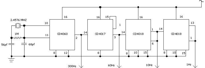

Here is a circuit I built sometime ago. It uses a easy to get crystal of
2.4576Mhz, and a CD4060. The 4060 divides the crystal by 8192 to get 300 Hz. The CD4017 divides by 5 to get 60 Hz. The first CD4018 divides by 6 and the second one divides by 10. If you only need 60 Hz don't use the 4018's.

Ahh. Thanks for input! But can't I use decade counters (7490) instead of the 4060s? Cause I've got a lot of them laying around. And I need the 60Hz output for the milliseconds, as already stated.

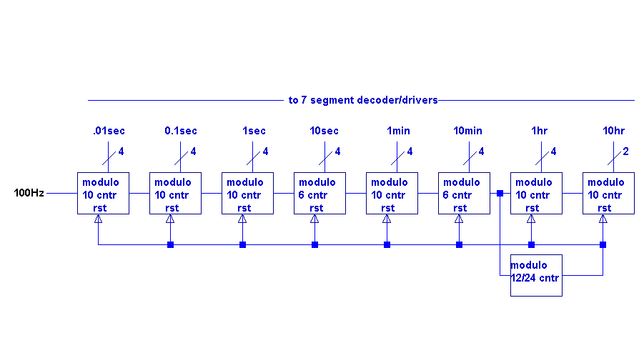

If you want to read hundredths and tenths of seconds, you need a 100Hz timebase, not 60Hz. Below is a block diagram of my understanding of what you want.
Are you planning on stopping the clock, i.e., using it as a stopwatch? Otherwise, there is no way I can see that the 2 least significant digits will be useful. They change too rapidly for the eye to track them.
