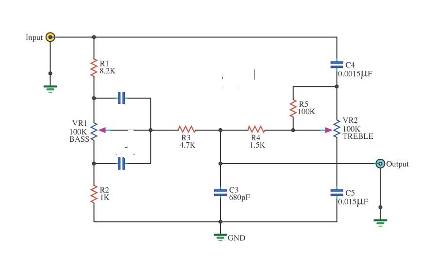

"a tone control that only ranges from 40hz-80hz. is this possible?"
"i know how to create bandpass"
:confused:I'm confused. Those statements don't seem consistent. If you know how, why are you posting here?
"i only want to use capacitor and potentiometer"
All the band-pass circuits I've seen require more than a capacitor and a pot. How do you manage it?

sorry for not showing for few days
because i dont have personal computer.
i only doing my projects in internet cafe.
this is my diagram
i want to now the value of my capacitor for 40hz-80hz bass control

Seems to be a variation of a baxandall tone control circuit.

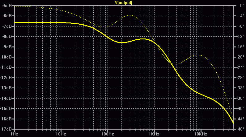

Maybe this will help;
