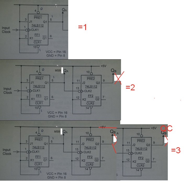

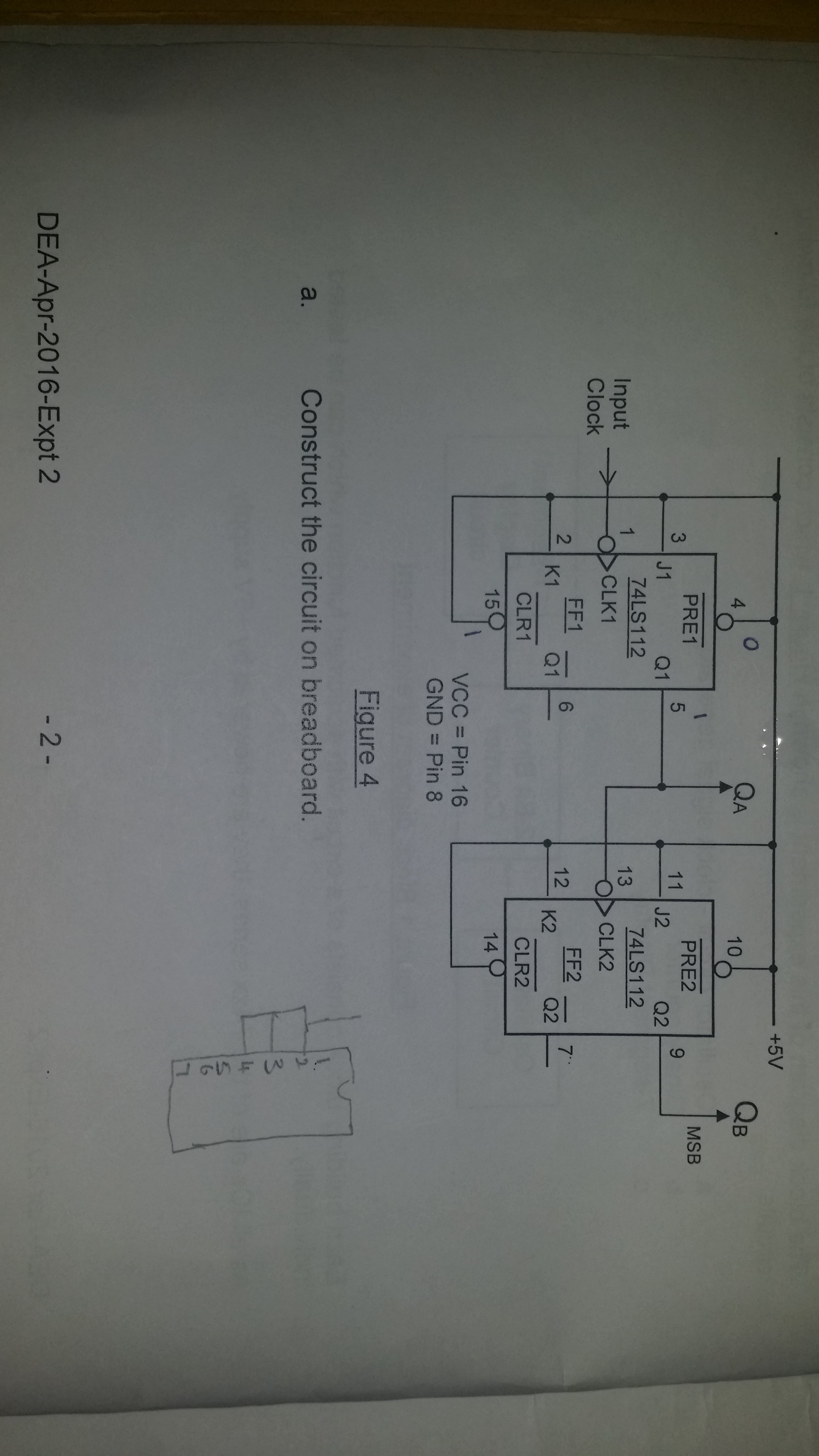

I have design a 2 bit diagram but I need help on 3bit diagram

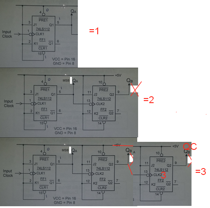

Can you see how do go to 3,4,5bit and on?
the number of bits in a counter is always limited by the number of memory registers, in your case each FF is a register.
