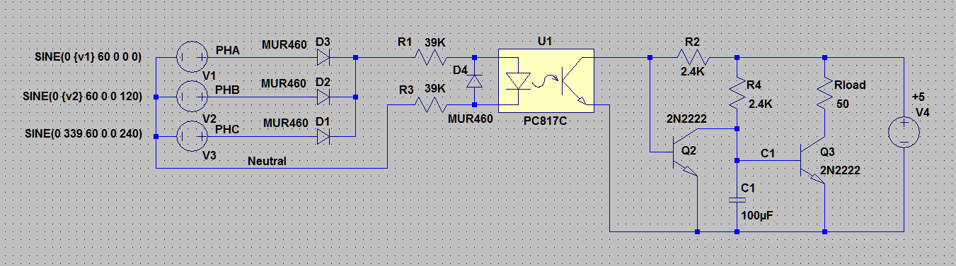

I discovered that if one or two phases is dropped, the output of a classic three-phase, half-wave bridge rectifier drops to zero volts periodically, whereas that does not occur when all three phases are present. Using this to advantage, I designed the attached circuit. Rload is energized as long as all three phases are present. (Note: The MUR460 does not have adequate PIV rating margin for the 3-phase voltage used, so beware. Schematic and model is for presentation of a design idea).

Hello guys with the help of you's replies and effort i have designed 3-phase detector circuit...
I have attached the working process in my attachment..
The circuit is working good !

What you need to do then, is to arrange things so that the relay is turned on all the time, except when any one of the chargers goes dead (including the charger that powers the circuit and the relay). Like, say, use an AND gate instead. Then use the N.O. contacts on the relay instead of the N.C. contacts of the relay.
what you need to do then, is to arrange thiings so that the relay is turned on all the time, except when any one of the chargers goes dead (including the charger that powers the circuit and the relay). Like, say, use an and gate instead. Then use the n.c. Contacts on the relay instead of the n.o. Contacts of the relay.
can you provide a simple circuit or visual image of it..
No drawing necessary. You provided one already. Just change the NAND gate to an AND gate so that your relay is ON when all the phases (inputs are present). Then use the other set of contacts on your relay.

Um, this is another problem than given in the first post?
Wel, given that you're using some chargers (that you didn't tell about in first post as far I can see) providing the neccesary output that you can detect using cmos gates, I'll recomend that you use a SR latch to make output stay on after you had 3 phase first time. You need to have the ON input to the latch connected to a 3 gated AND (just like the schematic above).

as others have mentioned before, simplest way to accomplish this is to just use three 230VAC relays (one on each phase) and connect their NO contacts in series.
if you prefer to do it with some electronic circuit, something like this should do:
- each phase is detected individually. note that detection is relative to neutral because line to line input may not turn off if only one of phases is missing.
- inputs are isolated
- presence of each phase is individually indicated
- presence of all phases is indicated (relay closed)
- relay opens if any phase is lost or power to circuit is lost
- phases are usually labelled L1,L2,L3 or R,S,T or A,B,C while neutral is N
using three 230VAC relays wiring would look something like this (here shown NTE relays R14−11A10−240):
