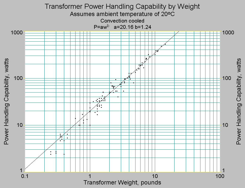

Nigel's advice to compare it to available transformers is good. Look up available transformers on the Stancor and Triad web sites.
I got the numbers for a lot of those commercially available trnasformers and plotted power capability vs. weight. These are not milspec or other high performance transformers, so they most likely are class A temperature rating--105°C hotspot max. The data show surprisingly little scatter. This graph will give a fairly good first cut at determining the power handling capability of a transformer. Just weigh the transformer and find the intersection of the straight line with the weight; read off the power handling capability. Then knowing the output voltage of the secondary, divide that voltage into the power rating and get the AC RMS current rating. Multiple secondaries share the total power. If using the transformer for a capacitor input rectifier circuit, then derate appropriately.

Impressive graph. That formula should come in quite handy.

Of course. The hobbyist will have to pay attention to that. The long time way of rating these things dates from the days when radios, TVs. etc., used vacuum tubes. The inside of cabinets got hotter in those days. The standard assumption was that the inside of a cabinet would reach a maximum of 40°C, and a 65°C rise above the 40°C ambient would put a transformer hot spot at 105°C. So all the other components were expected to be possibly as hot as 40°C if they didn't dissipate any power of their own. The transformer wasn't as great a heat source as the tubes.
The chart I posted assumes the transformer is convection cooled, sitting in the open. If a muffin fan is placed a couple of inches away from the transformer, providing a good blast of air, the allowable transformer dissipation will about double, providing about 1.414 times the output power.
