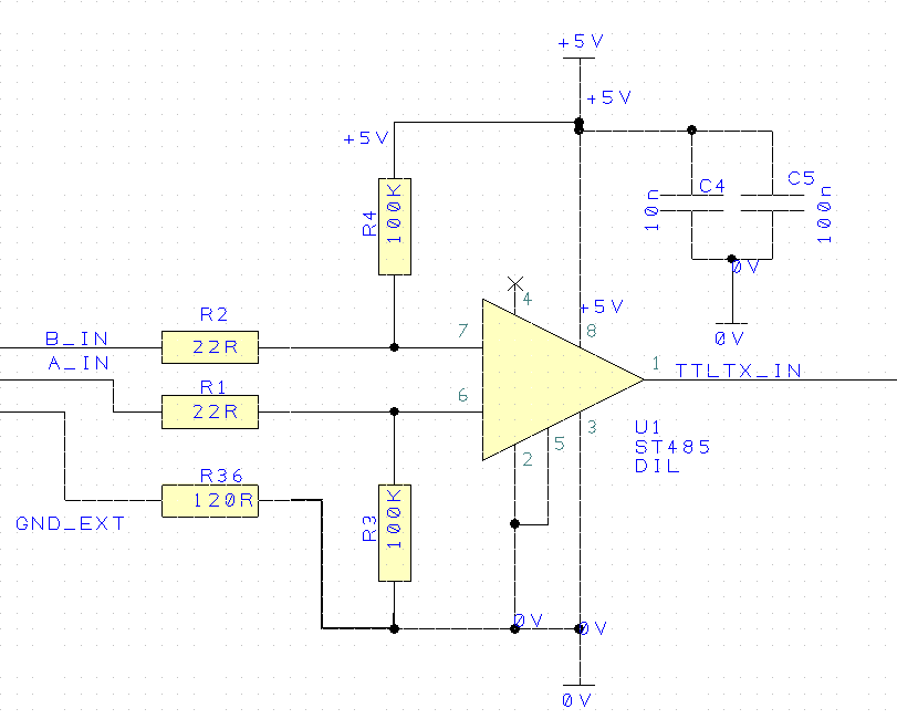

We use(d) a Linear Tech LTC485 for our RS485 comms, and over a few months have had several board failures, and a few field failures. Swap the chip and its all good again - the majority of the time. We use the DIP8 package, and so have placed an IC holder because it happens so frequently. It is the only part we have these problems with as well.

Yeah true, that does make me uneasy, usually I'd put on tranzorbs and polyfuses on the inputs, but this is a legacy board and worked perfectly for ages with the ST485 (now obsolete). Change to the LTC and we have these issues.

You could make a daughter board with connectors that fit the DIP socket, and add additional protection for the chips. Like you said, some transorbs or transils, a bit of capacitance etc. should give you a better protection than a naked chip connected straight to long cable runs.

Remove those 100K resistors. Protection is supposedly built in if the inputs are open. The IC is supposedly protected against ESD, but the 100K resistors might actually negate that. The next think I would try would be reverse biased Shockley diodes for the 100 K resistors which is typical OP amp protection.
KISS, how would the 100k negate any sort of ESD protection?
Also, i don´t think Shockley diodes are readily available any more. Schottky perhaps?

The LTC485 is a bit on the delicate side; the drivers and receivers maximum input voltages are only +-14V. And the LTC485 has no ESD rating, unless I have missed it.
The LTC2862 RS485 transceivers in the datasheet below are a bit more manly; the drivers and receivers maximum input voltages are +-60V, which is more practical. And the ESD rating is 15KV on the RS485 line pins.
The LTC2862 is pin compatible with the LTC485.
But, it is unwise to connect any chip to the outside world without appropriate protection- Vishay TranSorbs are normally the best protectors. With the LTC2862 a single 50v bidirectional TranSorb from each RS485 line pin to the chip 0V pin should do the job nicely.
If you stick with the LTC485 do the same thing but use 13V TranSorbs- this is just a very rough assessment- you would need to do a full analysis, because the operating voltage window is so close to the not-to-exceed voltage window.
Remember though that a considerable current may flow, momentarily, when the TranSorbs are doing their job, so the wiring and PCB races need to be substantial.
