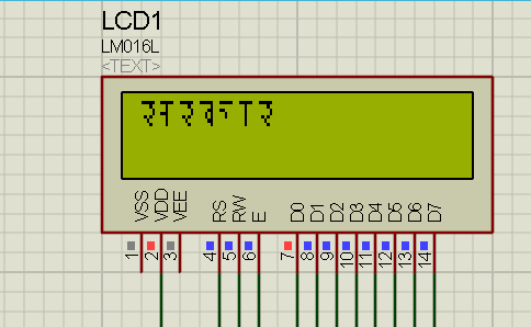

How to display message on 16*2 LCD in my native language Hindi
Djsarkar
I want to display message in my native language Hindi. I want to display सरकार on LCD
any idea how to do ?
PIC18F45K80, MPLABX xc8

void main ()
    unsigned char String []={"Please help"};
    Port_Initialized (); //Port Initialized
    LCD_Initialized();   //Initialized  LCD
    LCD_Data(String);    // Send a string to LCD
    while (1);
The trouble with these characters, they don't display well
You can only display 8 (different) characters. You may need to switch to a pixel based display. Plus, may need higher resolution.
