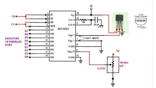

I want to display the output of LM35 on pc interfaced via parallel port and adc0804.I am not getting the actual idea how to do that. I have tried c,visual c++ and VB. It displays the values as 0 and 255 even if donot attach hardware circuit with parallel port. I shall be thankful if any one can help to figure out the problem.

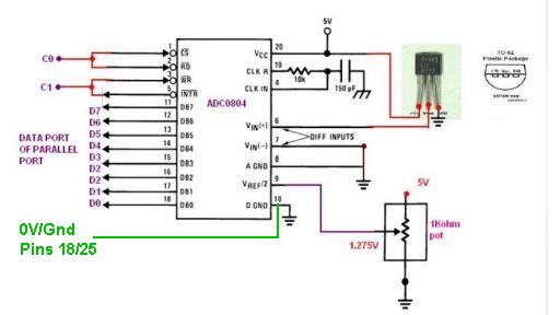

Checking your circuit, you are not showing a 0V/Gnd connection to the ADC from the PC's parallel port connector, pins 18 thru 25.?
Circuit is not showing gnd to adc from parallel port means that my circuit is not complete so that output can be displayed on pc??
Look at this image.
You have not answered my question in post #4.??

I have used inpout32.dll file in winxp but problem is still there. Can u provide me the source code so i can check my circuit.

i did that too, i cannot read the parallel port. i have doubt whether interfacing directly adc with parallel port might causing problemz, i have directly intefaced it with parallel port without any ic just by attaching the pinz of adc with connector db-25 as shown in schematics.do i need to attach any ic for getting values from adc to parallel port???
