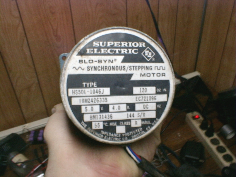

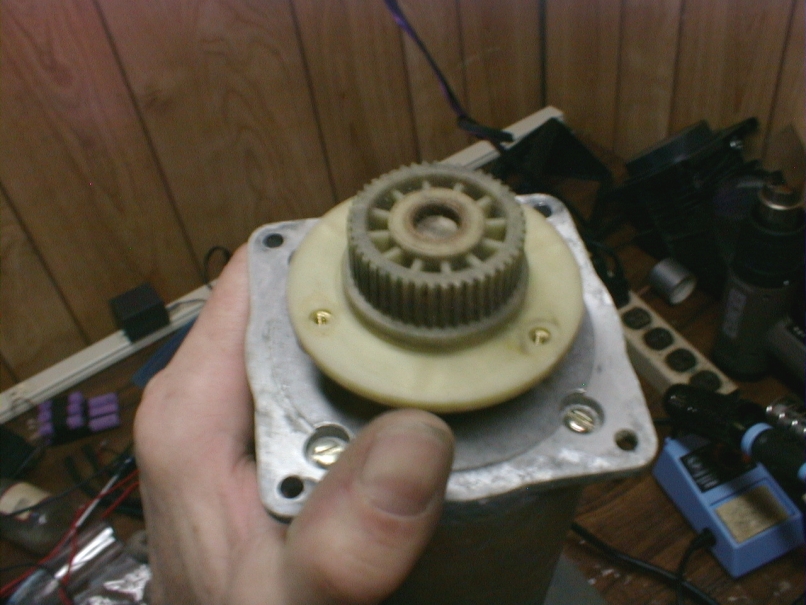

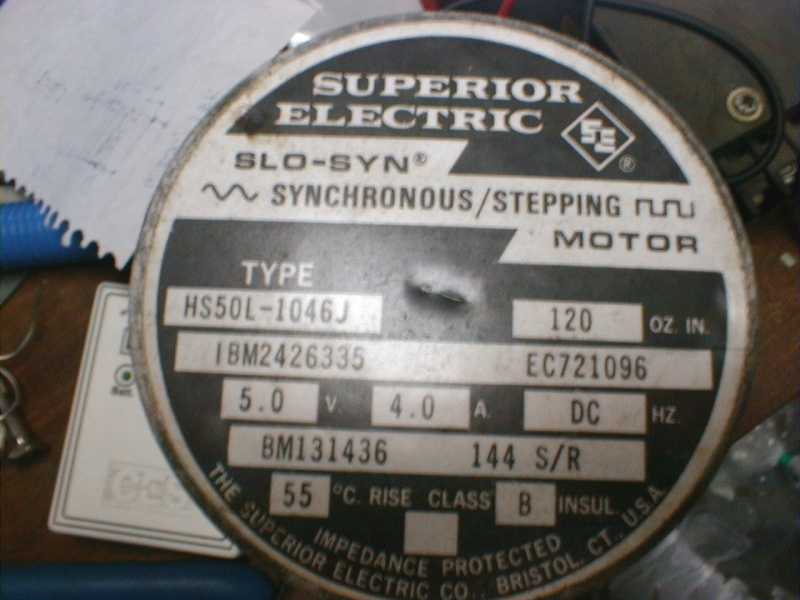

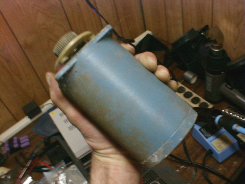

I've got a pair of huge stepper (about 8 lbs). Actually, should have a third one, but haven't seen it in years. Just pulled the one in the pictures, maybe pull the other one a little later today.
They are 6 wire, so unipolar I'd guess. Just curious if these are going to be difficult/expensive to use for something. Don't know where to find a 5v/4amp supply, or what parts I'd need to handle that kind of current. 120 oz/inch sounds like a lot of torque.
Would battery power be practical, seems like a huge draw. Think these could move one hell of a robor, wonder how much weight they could handle on wheels...

I think that is the voltage and current in one phase. So with two phases on at one time that's 8 Amps per motor. TIP33C and TIP34C power transistors should handle that load OK.

They look like SLO-SYN motors from Superior Electric. Why do you think IBM had soemthing to do with them?
HS50L-1046J is the part number.
Oh... I see it there is an IBM in the number underneath the part number. Just a coincidence.

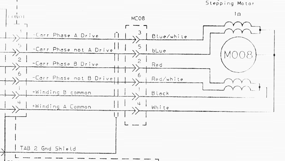

Just found the motor in the service manual, got the wiring. Also, with any luck might be a driver board for it. This couldn't be so simple, but then again the manuals are dated 1986...

All you need is 4 NPN transistors to drive it, probably power darlingtons to give enough gain - and a PIC to drive them.
Why won't an AVR micro work? :) Yeah, I figured I'd have to dig out the power transistor for this. If I can locate the driver board, I'll have the right parts on hand (probably do already). Might even be able to use the board as is, rather than messing around. The 4 amps is way more than what I'm use to working with, little concerned about fire and electric shock. Won't stop me, just proceed with caution.
