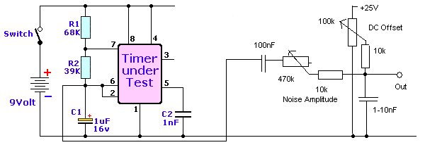

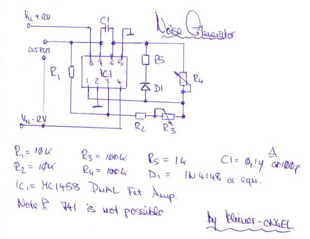

let say i need 17 to 23 p-p square wave how can i .......
when there is 555 is not working MC1458 is not working LM741 is not working
is there anthing as to try ........is project make my life hard .........
i just need 17 to 23 p-p sqaure or sawtooth
here
are teh circuit that i make but non of them giving what i want
okay, how many threads do you have going for this exact same topic? this is at least the second one that I have seen. it is very bad etiquette on a forum.
if you're not getting the response you were hoping for in the first thread, tough. Making more threads to try to get more attention is just rude, and wastes more of everyone's time.

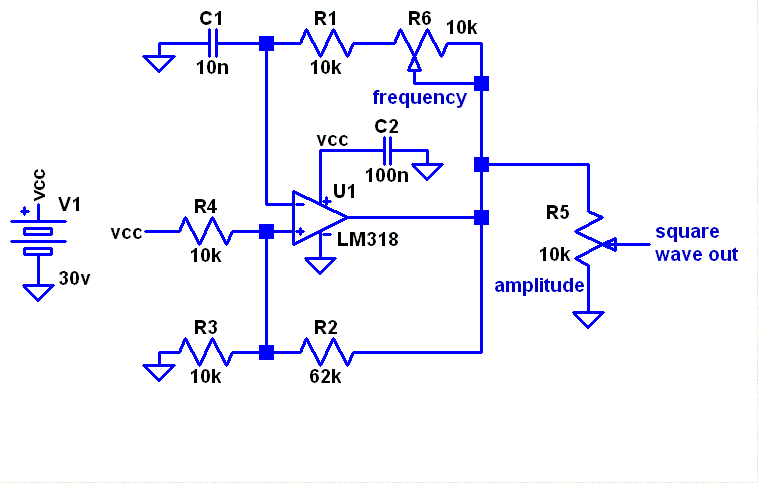

LM555 won't handle the supply voltage you need. LM741 does not have adequate slew rate. Below is a square wave generator using an LM318, which solves both problems.
