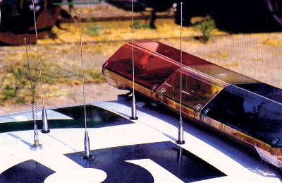

With four antennas and diode switching, you can use doppler principles - sequentially switch each antenna to an FM receiver and you get and audio tone at the "rotation" frequency. The phase of that relative to the switching phase tells you the direction of the transmitter.
An example design:
(If you have ever noticed that some police cars have a cluster of four identical antenna on the roof - that's a similar setup using the same basic concept, for locating stolen vehicles with "Lojack" style transmitters fitted to them).
An example design:
