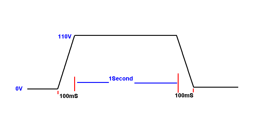

hello could someone help me design a circuit in which the square wave should have an amplitude of 110V with rise time being 100ms ,ON time being 1 second , and fall time of 100ms.
i know you could generate a ramp with 100ms rise time by constant current charging a capacitor and constant current discharging it for 100ms to get the falling ramp. but how do i for 1 sec on time and how to do this for 110V.
Well that could be just half the wave if it's AC. We don't have enough info as yet.

That is what i wanted. A dc signal which has a amplitude of 110V with (Tr) rise time of 10ms, ontime (ton) 0f 1sec , fall time (tfall) of 10msec with total time period being (T) 1.2s.
For this pulse to have a period of 1.2 seconds means that the voltage ramps up immediately after it hits zero volts. I s that what you need? Or does the voltage need to spend time at zero before the next pulse. Do the pulses need to run continuously, or do you need a single pulse triggered by some event?
Also, in your original post you asked for rise and fall times of 100mS. In post #7 you state 10mS. Which is correct?

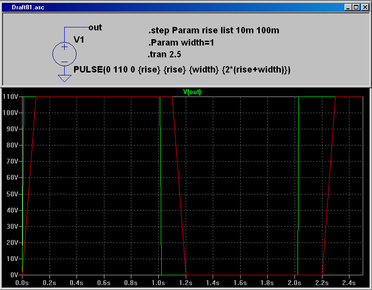

sorry for my mistake it is only 100ms and not 10ms. And also I want this to be a continuous signal once it reaches zero it has to start back again.
I forgot to add my real questions to my earlier comment. Sorry about that.
How much current does this signal need to provide? I am assuming it will be quite low, but can you put a number on it?
Does it have to be generated by an analogue method as MikeMI has shown?
