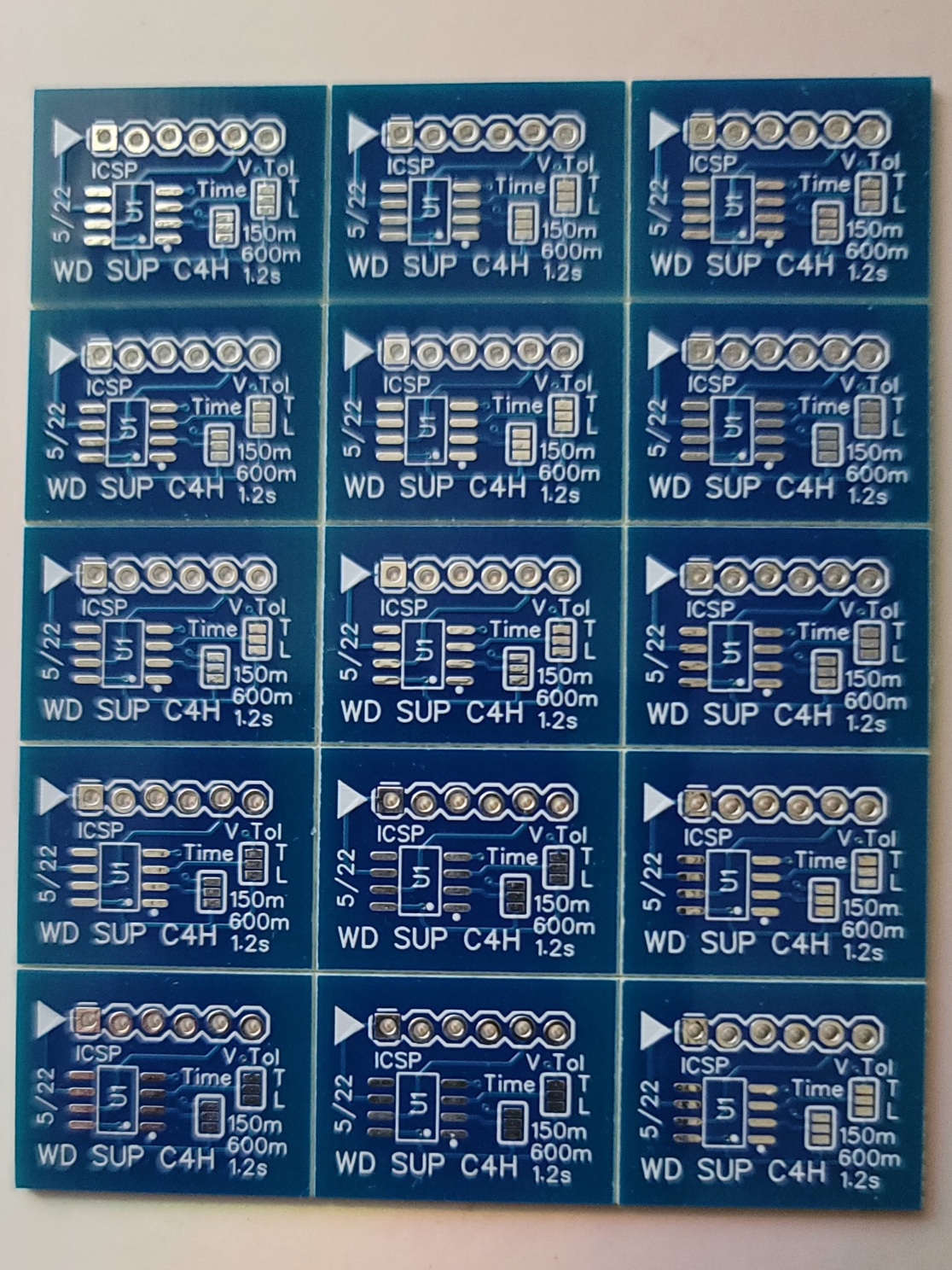

Probably not useful in your case, but you could also panelize the boards. Elecrow for one does not charge extra for v-scoring with one design on a panel. Instead of 5 boards for $5, you could get 5 panels with 10 or more boards on each that snap apart. FOR THE SAME PRICE.
Note: you can create a panel with different designs on it, but the up-charge from Elecrow is more than $5 per design, so it makes no sense to do so.

I too use JLC. But if you're panelizing boards, Elecrow is the first choice as there is no upcharge for panelizing a single design. JLC has an upcharge based on the number of boards on a panel.
