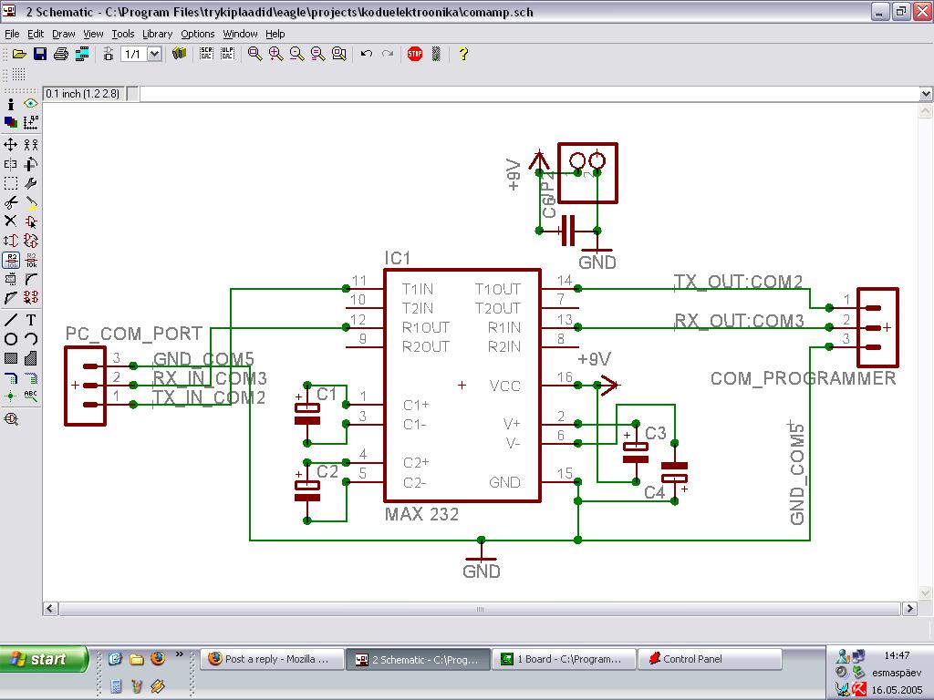

my problem is, that my usb->serial(COM) converter isn't working. My laptop sees it (it says hadrware working properly) and generates a COM port, but this port is not usable. I'm trying to program my pic(axe) with it and it says hardware not accessible. When i unplug the usb cable from my laptop and stick it in the PC i can download the program in my PIC with no problems. I think my PC is old enaugh to have USB 1.1 not 2.0 but laptop is pretty new.

now i'm bilding an amp betwean so it might work better

well i changed the name. so the problem is that the signals from my usb->com converter are to weak for me to program my pic so i'm searching for an amplifier to get it operating. the schematic with a MAX232 was suposed to do so, but as it seems it can't right?
and now i'm seartching for a better amplifier circuit betwean com and my pic.
