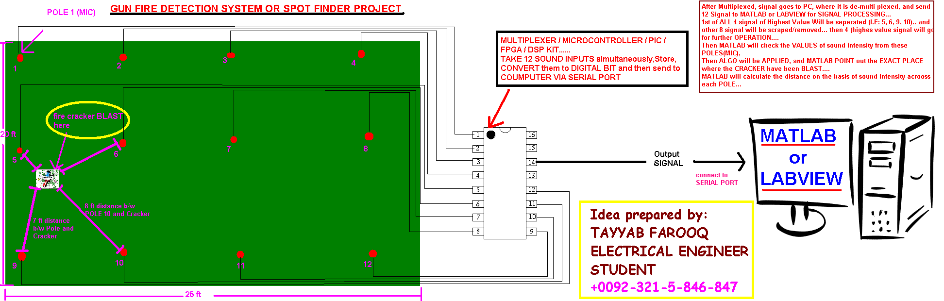

I am Working on My PROJECT NAMED
GUN FIRE DETECTION SYSTEM
or SPOT FINDER SYSTEM
In This Project, I Find the Spot, where the Gun has been fired....
So i have to get a AUDIO from 12/16 mics simultaneously to give to COmputer and then Calculate the SPOT via MATLAB or LAB VIEW with the help of ALGORITHM...
well i getting trouble to give 12/16 multiple sound Inputs to COMPUTER at the same time, as it have only 1 input module
so i work on this, and gues that i can be possible with the help of MICROCONTROLLER/ PIC/ FPGA etc
but i am unable to find the model Number, or PROGRAMMING GUIDE
so if any one can help me about this, i shall be THANK FULL to him, that HOW can i GIVE 12 or 16 inputs(audio signal) to computer simultaneously????

The information you are trying to extract from the microphone signals requires that you preserve the "phase" of all of the signals up to the point where you apply the numerical algorithm. To do that, you will need 12 ADCs, one for each channel, each with a sampling rate sufficient to follow the rise time of the audio signals.
A super-fast ADC with a 12:1 multiplexor could do it too, but I'm guessing that you would need a video ADC that samples at tens of MHz.
None of this falls into the relm of what PICs do. Even the so-called DSPics might not be up to it.
Don't forget that you will need 12 anti-aliasing filters, too.
If these terms don't make sense to you, you are looking at a long-learning curve... You might want to hire a consultant that knows DSP (sampled data systems).

well, one more thng that i want to mention that, i don't use GUNFIRE for sound source in my project...
i just put 12 mics at different position in 25ftx25ft area...
and i use FIRE CRACKERfor producing sound...
i have idea in my mind that i use PIC or micro controlller or FPGA, that i PROGRAMMED, which take 12 values, store in it and choose the MOST HIGHEST 4 values, and send to computer via SERIAL or MIC PORT...
so i am asking about a PIC or FPGA TYPE Via wihich i can do that above task....
OK---I thought you want to use phase to get distance. In that case you can find distance and direction to 1cm.
If you just want MOST HIGHEST value, then use a peak detecker to hold the highest value. Then a simple PIC with ADC to measure which is highest. Then send data out to computer.
Phase is nothing more than the time the signature is detected.
If you can program a DSP to characterize the signature of the audio blip you can time stamp it and only send the characterization information rather than the raw samples it'd be several orders of magnitude less data to transmit.
read this plz
I would like to be my PROJECT working like this shown in DIAGRAM
now tell that how i sence 12 signal and send to computer, which PIC/Microcontroller i preffer to use????

TAYYAB,
The sound is very fast! The ADC in a PIC is too slow. It will only capture one MIC input.
Find out about analog peak detector, using op-amp + diodes + capacitor. This will find highest voltage and hold for a time period. This will give time for the slow PIC to read all 16 voltages.

well i m still checking for ATMEL,MAXIM PIC/CONTROLLER, so that i find out the better one which hold and store data and then transmitted..
wel i have one question more from you, that is there any more POSSIBILITY to send 12 signal to computer simultaneously?????
Sound Card=good idea
I think it only has 2 MIC inputs. The other inputs are line level so you will need a pre-amp.
