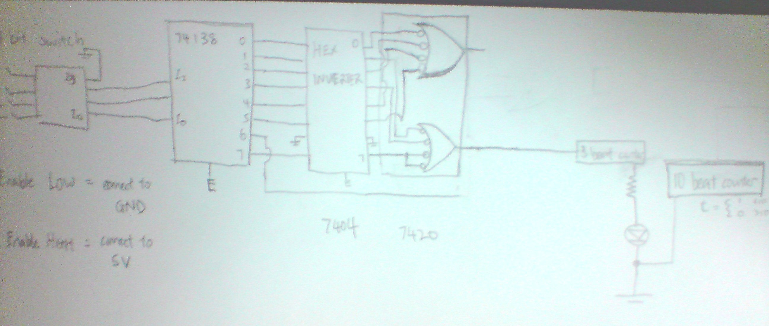

I'm rather stuck in my design project.. 1st I havta input a 3-bit information using dip switch and push button to a circuit and after going thru numerous dencoders and magnitude comparator, a green LED is supposed to light up only for 3 seconds and not lighting up otherwise.. Have a 555 clock chip, and I've been thinking of using a counter of 3 beats but just couldn't figure out how to connect them...

Configure the 555 timer as 3second monostable, which is triggered by the output of the comparator.
To post a circuit we would need more info on the voltages, timing of the comparator etc...

Hi Eric,
currently my 555 timer is running at 1 second period, n i'm using a 7805 voltage fixed voltage regulator.. Idea is from 3 of the 8 outputs from 74138 it will b directed to a LED which needs to light up for 3 seconds, then goes on to store as '1 bit' information in a flip flop for 10seconds before being reset to 0.. Can my circuit work?
Up to here should work OK.

sorry i oni have hand-drawn sketch, haven do up on schematics yet.. and apologies for the poor resolution, basically after passing the 3 outputs thru a NAND gate ( since its an either-or case for my design assignment, if the lower branch gives me a '1' i will get a '0' for my upper branch, which i haven finish my design ) my idea is using that output I can pass in to my counter to give a pulse of 3 seconds, den '0' otherwise to light up my LED..
den I will pass the '1' into a flip-flop ( which in the drawing is a counter, sorry again ) that stores a '1' for 10s and then reset to '0' after 10s..
but i cant help to feel my design is kinda naive =/

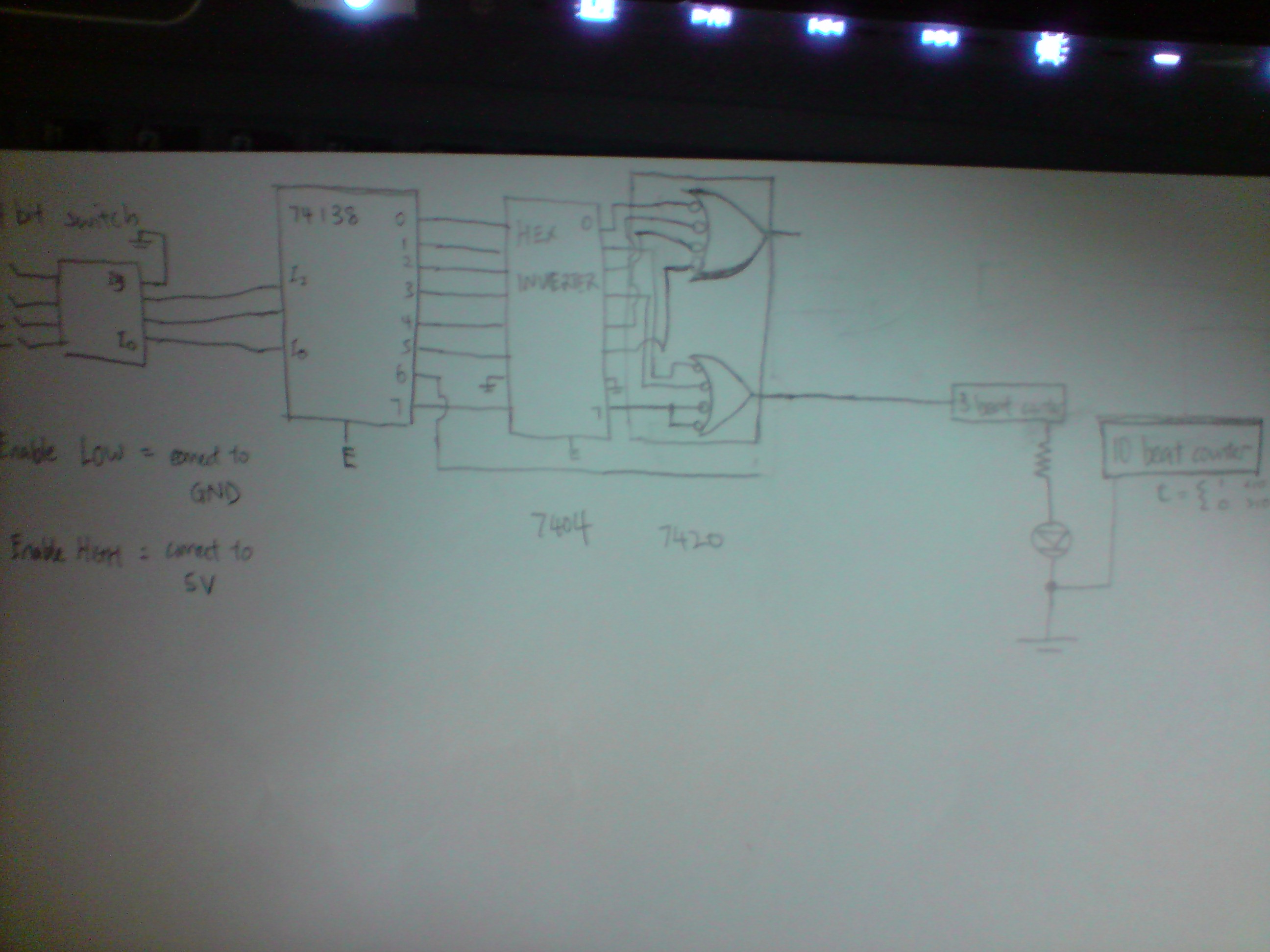

The design is too fussy [ I am being kind to you ...:)], dont worry we have all been there.
I have lightened up your sketch, give me time to thru it.
EDIT:
Looking thru you circuit, its difficult to understand what you are expecting the circuit to do.?
Post a full circuit with some explanation of its function.

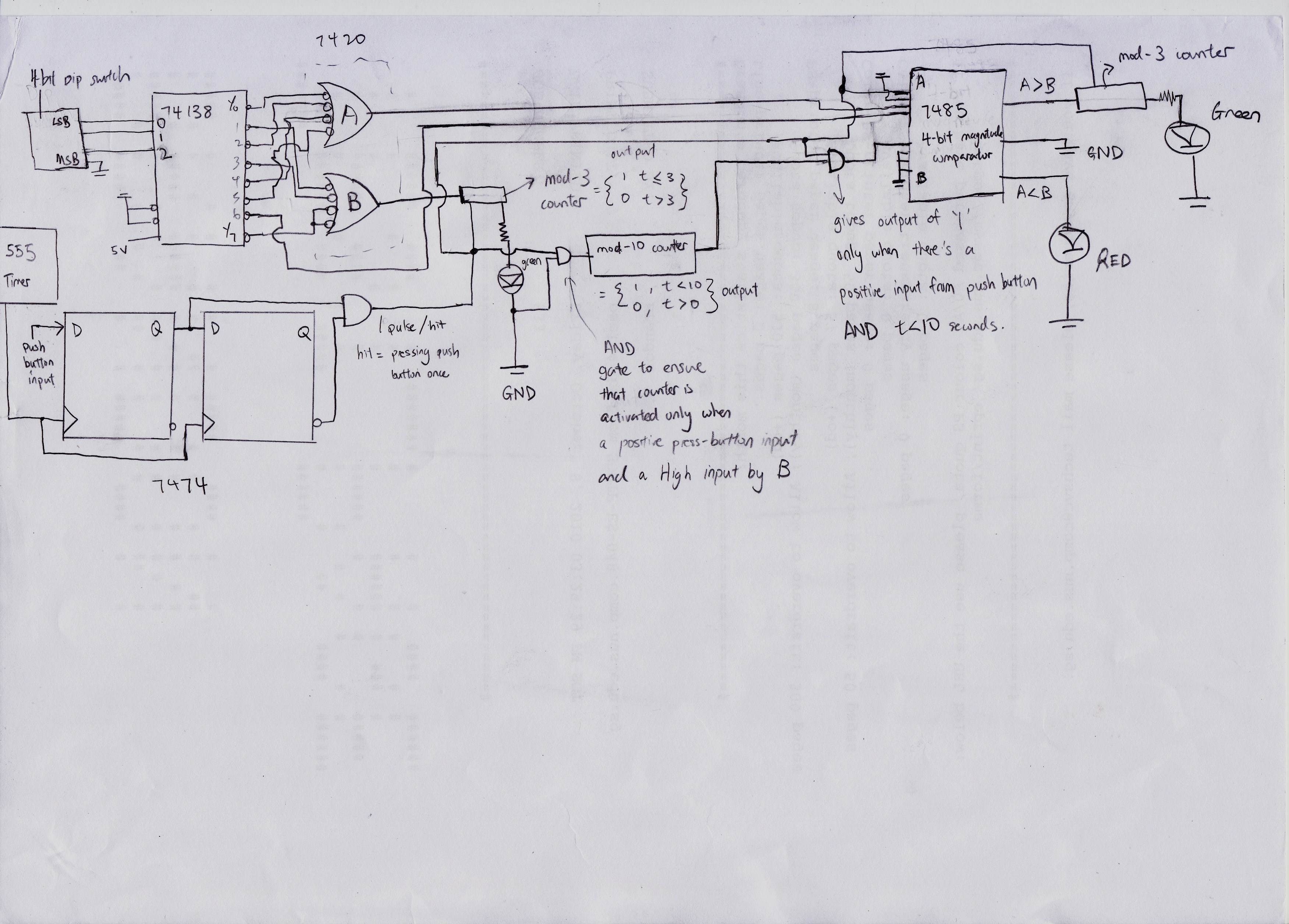

I am still struggling with the concepts =/ my full circuit isnt completed 'cos there are still components I do not know how to implement.. Basically I have most of the MSI
available in lab, and right now I am trying to achieve these outcomes with my circuit:
1) Light up my LED for 3 seconds, during which I should disable my 74138 from receiving any input ( counter and ??? )
2) store a 1-bit information and keep it for 10 seconds before reseting it (J-K flip flop?)
3) implementing a push button to send 1 cycle of input from a 4-bit dip switch
very sorry for the sketch =/
Maybe it would be best not to worry about the circuits yet but describe fully the function you want to perform.
Here's the sketch as well as the functions i aim to achieve but dont know how to get about doing it..

Not getting the full concept of what needs to happen but have an LED light up for 3 seconds then shut off for 10 seconds?
sounds like a perfect candidate for a simple 4017 decade counter and/or a programmable up/down counter
need a better description like why are you having to store a bit for 10 seconds?
what function is the dip switch playing?
maybe try siming it in LT spice?
and where and what does the pushbutton supposed to do?
I can't locate the pushbutton?
hi MrDeB
the push button is at the 7474 chip, the function will pass in 1 pulse into the circuit..
I have finished wiring most of the circuit except the lighting of the LED for 3 seconds using LEDs.. Btw I forgot to mention I only have the TTL chips to work with..
