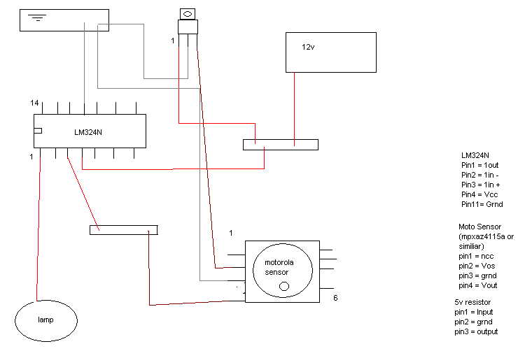

i have small dilema maybe you can help w/
on the op-amp (i got a quad coz that's all radioshack had)
and i assume that i'm only going to use 5 of the pins
pin 1 (1out) pin 2 (1in-) pin 3 (1in+) pin 11 (ground) and pin 4 (Vcc)
pin 11 obviously will go to my ground point (same as where my regulator and sensor will go)
pin 1 will obviosly go to my lamp or whatever i may have to but inline before the lamp such as a pots?
pin 2 would be ground? or is that for inversion?
pin 3 would come from my sensor's output (the .214 to 4.9v output)
and pin 4 would go to 12v supply? (would I need regulator even if the opamp can take +16vdc or +32vdc?)
thanks
sorry to keep posting what seems to be stupid questions (coz they prolly are)
here's what i got so far in jpg (can't really figure out pspice that quick)

i kind of don't really understand this
it appears that the "fan/light dimmer" is looping through the op-amp a second time... can you please explain to me the reasoning behind that
also the oscilator as i understand it is there to prevent the negative voltage kick from the motor... is that needed for a .24amp neon lamp?
and also would i need the comparator (being that i have no clue what it is?)
also why the mosfet (would i need)?
i can understand the caps tho
Allright let's walk you through this,
The op-amp you got from radio shack is not capable of powering a bulb by its self it needs help in the form of a power transistor or mosfet device.
It is designed to amplify the voltage level but cannot provide sufficient electrical current to drive a bulb, the transistor or mosfet take the current load.
Now the normall way to dim a bulb in a simple case , say with just a battery and bulb is to put a resistor in series with the circuit this works by reducing ther current flow and the bulb dims, the trade off however is that the resistor gets hot , same applies to transistors ( tis y big audio amps have large heatsinks)
Pulse width modulation on the other hand works by just switching the bulb on and off faster than the human eye can detect and this creates the illusion of the bulb dimming , kinda rough explination but the system works very well and gives good control of the lamp brightness.
Neon bulbs are not suitable for automotive use they require voltages upwards of 80v to function.
The motorola application circuit with the LM3914 bargraph display would be a simpler beginners project.

i was looking at cold cathode neons... requires a
12v and a .24amp draw
so what i would do after the op amp is to add in the mosfet
i believe that the amperage (i'd have to check) coming from the op-amp is around .4 amps...
thanks
You might have a bit of a problem here, cold cathode tubes operate at around 120volts they use a step up voltage converter to get this from the 12volt automotive supply. Reducing the input voltage in order to dim/reduce the output for the neon lamp may cause the voltage converter to stop working. It all depends on how it's designed to work.
This adds another level of complexity to your design.
You can still use the PWM circuit , but instead of a power transistor or mosfet you will need a device designned for switching high voltage , the triac.
Instead of switching the 12v supply to the voltage converter this controls the output (high) voltage much like a houselhold mains lamp dimmer.
oh... now i'm really lost i think
use triac after the opamp rather than a mosfet?
i do still need to step the voltage down for the sensor... then back up for that to have control... I'm gonna try and get some books that may help me, but i'm getting more and more lost as i think i'm getting it ;D
ah the cathode tubes i was looking at came w/ sound triggers... Which i believe would dim the lamp (switch on and off as fast as bass was detected)
so I believe they would work... Also they are for 12v personal computer supplies... and run only off 12v input... so i don't know :/
