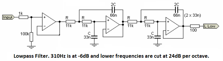

When you use a bass boost circuit then it actually cuts high frequencies so that bass frequencies are louder than them. The circuit is called a "lowpass filter".
You did not say how sharp you want higher frequencies cut. Here is a circuit (use audio opamps and power them with a plus and minus 12V supply)
that cuts highs at 24dB per octave. If the middle opamp circuit is removed then 310Hz will be at -3dB and it will cut highs at 12dB per octave.
In that picture did you use LM386 as well? Can you suggest me a better amplifier IC?
The lowpass filter circuit I posted uses opamps, not a power amplifier. The circuit passes low frequencies to a power amplifier but cuts high frequencies.
The opamps can be any audio opamp like a single TL071, dual TL072 or quad TL074.
There are hundreds of power amplifier ICs available that produce much more power than an LM386.

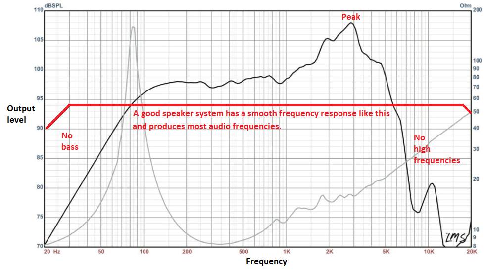

A woofer is a low frequency speaker. A high frequency speaker is called a tweeter. It needs a power amplifier driven from a highpass filter circuit. A good tweeter has a smooth frequency response. A cheap tweeter has a rough frequency response and sounds awful. An ordinary speaker has a peak in high frequencies that sounds awful, maybe that is what you want to smoothen? That is why a woofer is used for low frequencies with a lowpass filter to cut the high frequencies and cut the high frequency peak, and a tweeter is used for high frequencies with a highpass filter.
Here is a frequency response graph of a cheap speaker that sounds awful and a good speaker system that sounds good:

Bass is low-frequency sound we associate with thumping (boom boom). Bass frequencies start at 20-200Hz, while human ears perceive frequencies from 20-20,000Hz. I suggest you to attach your speaker to your computer and install a software who has inbuilt bass option. I hope this will surely help you to increase bass on speaker.
