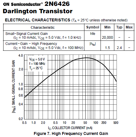

You asked about using a darlington transistor to boost the output power. Then why didn't you look at a datasheet?
Here is the specs on the datasheet of a small darlington transistor. At 1kHz its minimum gain is 20,000 but it is only 1.5 at 100MHz over a narrow range of current. So its output power is almost the same as its input power and it is useless.
thanx guru.. I got it now.. N I must try 2n2219a or something else
