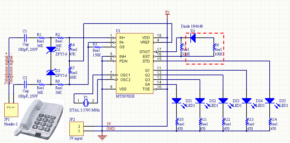

Hi guys I made this DTMF tester circuit & its working.
The problem is some times I have to press & hold the buttons in the keypad to make an output. Because steering pin (STD) won’t go HIGH sometimes it’s blinking.
It won’t detect any signal without the optional circuit marked in red (guard time adjustment) also it’s very poor to cell phone dialing tones.
Is there any way to increase the sensitivity in my circuit? Is my input area values are good?
Thanks.

Hi Suraj,
you expect to receive audio tones in the frequency range 0.3 to 3.4 KHz- from the telephone line. as per your diagram you have coupled it using 100pF capacitors on each limb. and there after you have adopted two nos of 56K on each limb.
if you analyse the impedance of this for audio frequencies - you will appreciate that thhe circuit is under coupled. generallt we beleive that telephone impedance is 600 ohms. so anything above 10*600= 6K ohms is amounting high impedance. and the capacitors need to be around 1uF
more audiowill come to the 8870 and there is no need for maiking the circuit more sensitive.--
only you have to have guarding say two diodes in opposite parallel across the 8870 input, instead of 5.6 ZPYs after the isolation caps. this is beacuse, the audio level will generally be around -6 to -10 dbm. this will work out to less than few mV
hope this should serve you
Sarma
The 100pF capacitors are for coupling RF, not DTMF audio tones.
Look at the datasheet of the ancient DTMF decoder.

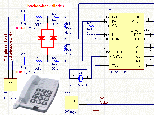

You have 0.0001uF capacitors (100pF).
The circuit needs 1uF capacitors to pass DTMF audio tones. 10,000 times more.
Remove the zener diodes and connect two 1N4148 diodes back-to-back across the inputs of the IC.

Sarma suggested reducing the values of all the resistors and using bigger capacitors.
The datasheet uses resistor values similar to yours and uses 0.01uF capacitors.
The datasheet doesn't have protection diodes.
I show the new capacitor value and back-to-back diodes here:

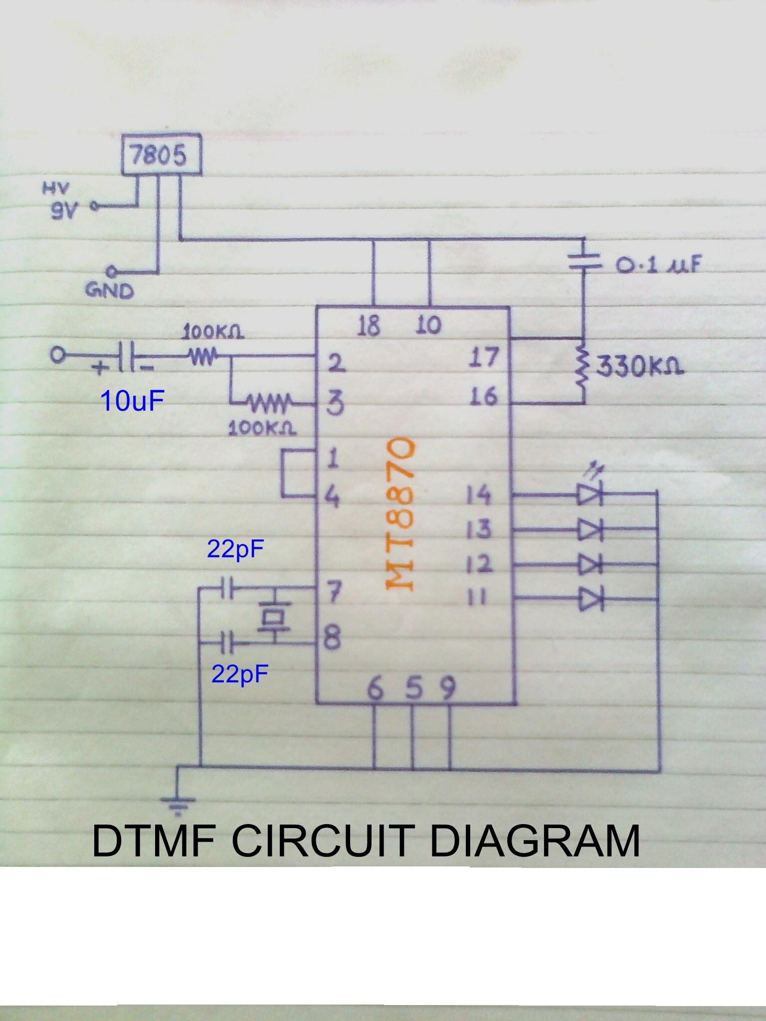

Hi audioguru
i have made a DTMF circuit withMT-8870 but having a problem:
I am using two cell phones (one as Transmitter & one as receiver) but when i call on Receiver-Mobile and press buttons from Transmitter-Mobile the tones are not captured by IC MT8870.What should i do.
Both Mobiles work fine when i connect to circuit one by one and press buttons
i am uploading the diagram please give me suggestions if capacitors or resistors values can be modified to get desired OUTPUT

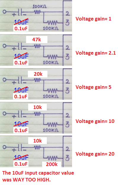

I do not know how much gain your circuit needs so here are some choices:

Hi audioguru !!!
Your suggestions were very helpful....I made changes as you suggested and it worked.
Now my DTMF circuit is complete and WORKING..............Yee .......Haa......
Thanks alot

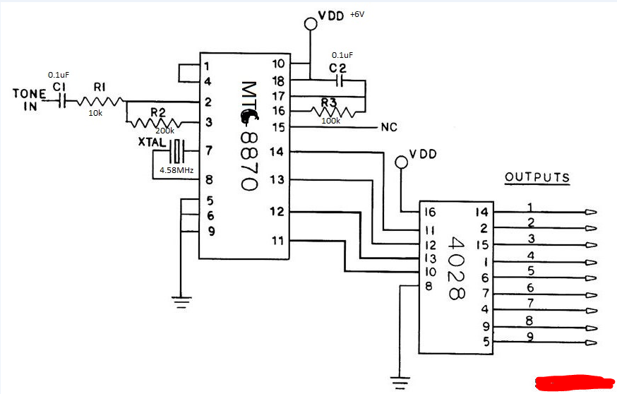

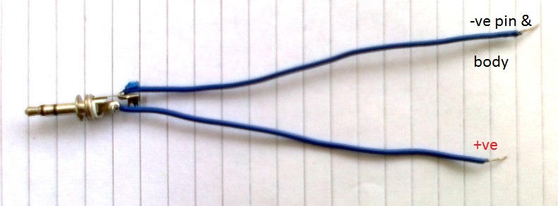

I am uploading it here as it is said "SHARING IS CARING !!!".Thanks again
